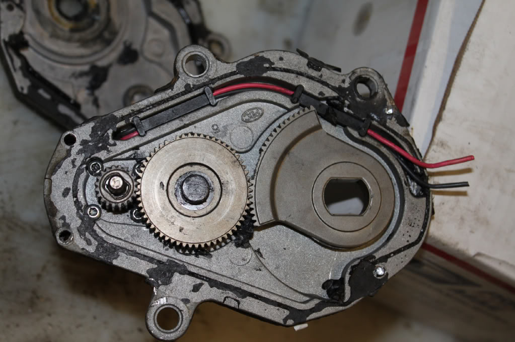

If you can hear it trying to shift both at the TCCM (clicking) and at the encoder motor down on the transfer case (whirring), then you may be experiencing the condition I repaired on my Uncle's Sonoma.
Originally Posted by swartlkk
This is what happened in my uncle's truck that prohibited the shift to 2HI:
Notice the missing teeth on the gear. The missing teeth prohibited the encoder motor from moving back to the 2HI position. The position I put the gears in is close to 2HI. It was actually stuck on the other side where only 4HI, Neutral, and 4LO.
is this picture what the encoder motor looks like inside? can you get the gears and things separately?
