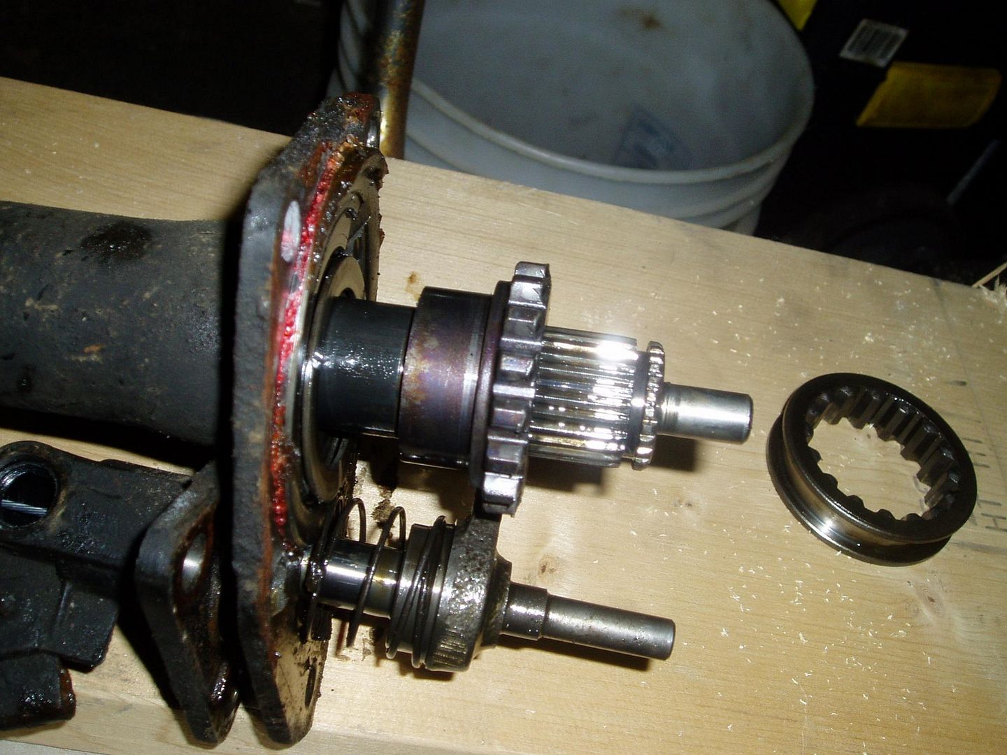

The actuator needs to pull the cable 1/2" to 3/4" to fully engage the collar inside the front axle. If the cable is being pulled that amount, then there is a problem with either the shift fork or collar inside the front axle or possibly the cable has become disconnected where it connects to the shift collar.
Here's what it looks like inside:
