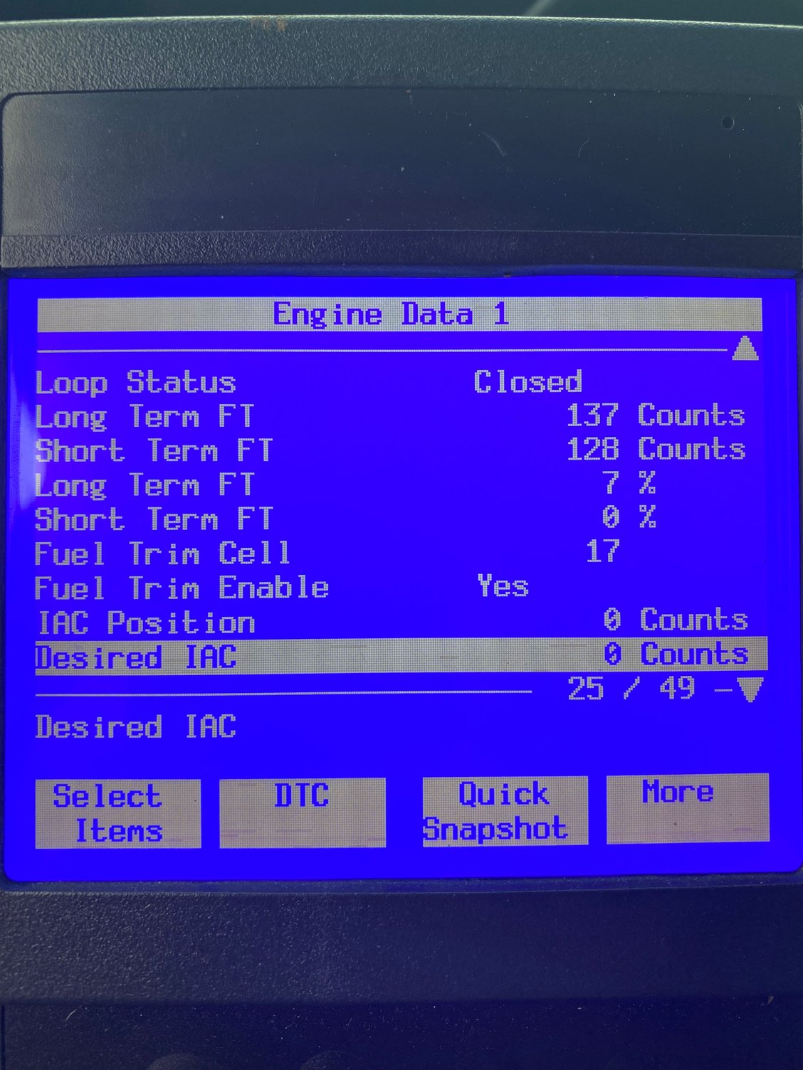

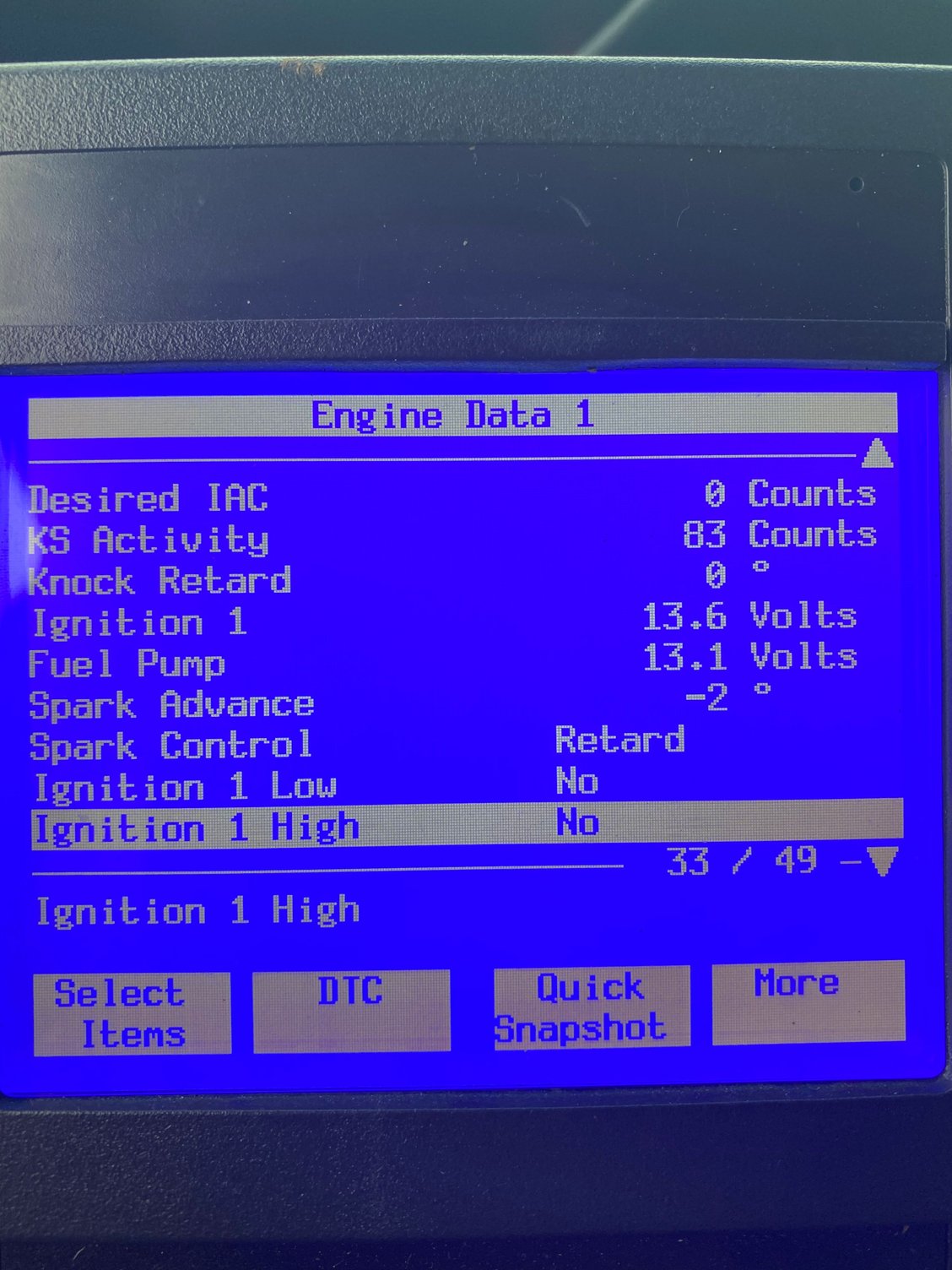

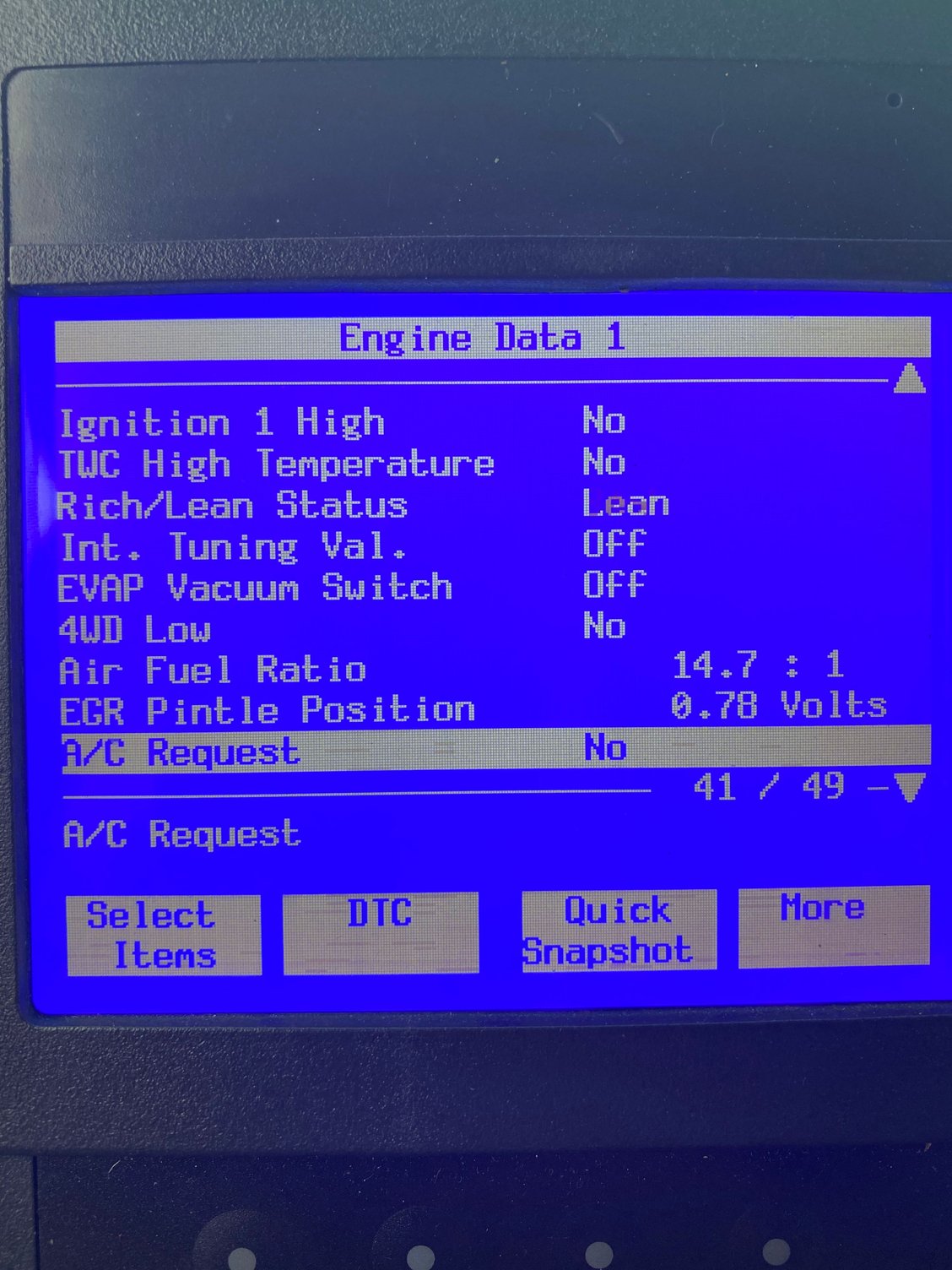

My 95 GMC Jimmy is idling high and will not idle at the desired RPM. It happened to me after running down the highway for about 20 miles. The TPS and MAP voltages increase with RPM. The IAC count is 0 at idle and goes up to about 50 at full throttle when the engine is warm. EGR valve also seems to be functioning correctly based off of voltages. I cannot for the life of me find a vacuum leak. I’ve blocked off both vacuum ports at the back of the intake and there was not change to the idle. I’ve smoked the intake through the brake booster vacuum hose and found no significant leaks (a small leak through the opening in the intake for the throttle shaft. Any thoughts would be greatly appreciated.

Its a 1995 so I have the OBD II style connector, but it is not compatible with most scanners. The scanner is a Bosch Veronix GM Tech II scanner. There is no MAF on my setup, it has the CMFI system so it only has a MAP sensor. PCV valve is working correctly and has no leaks. I hope the lower manifold intake gaskets are good, the engine is only a year old. I would have thought the smoke machine would show any leaks in the gaskets. I believe the TPS is okay, it doesn’t have a power steering switch. The charging system is working normally.

You will have to bear with me because you probably have the transitional ODB 1.5 system and I won't be the first member to be humbled by this system. I also don't understand the concept of counts in scan data. That said:
Since your truck uses speed density instead of mass airflow its critical that the IAT and MAP sensors are accurate. Look at their values on a cold engine not running and compare those values to ambient conditions. Do the same thing with your ECT even though that looks OK on your warm engine. Move the TPS sensor through its range of motion and make sure the reading is glitch free and makes sense.
How many O2 sensors do you have? Your display looks like a 4 banger with one pre and post cat sensor and only one set of fuel trims.
Can you see your O2 sensor output in live data graphic format or with a scope? If not can you see the voltage values in lave data to see them switching?
Does your throttle body need to be cleaned?
Have you done any removal/cleaning/inspecting/testing of your IAC?
Has your fuel mileage changed significantly?
George

I'm not sure about the time period on the 241 counts. I'll play around with the scanner and try to figure it out. I know if the IAC count is 0, the IAC valve is fully extended. Here is the best reference I could find. TPS and IAC. The fuel trim count of 128 is equivalent to 0% fuel trim for both short term and long term fuel trim. So on my scanner the long term fuel trim count of 137 is equal to ((137/128)*100)-100 = 7% fuel trim.
