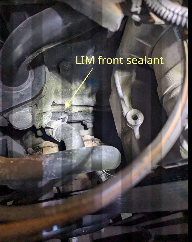

The leak can bed anywhere. I've had three slow leaks. 1.) a crack in the plastic part of the radiator near the upper hose that finally got big enough to notice steam, 2,) heater hose at the clamp down in front that finally burst through and overheated the engine (detonation) 3.) leak through the sealant in the LIM crossover in the front of the LIM (seen behind the thermostat, see pic).
You have a pretty good chance of seeing the leak when the radiator water temp is high and engine is running.
Dang. I went out to take a pic of where the LIM leaks and saw my coolant was low. Added some and it started leaking from underneath. Looks like I need a new water pump!
