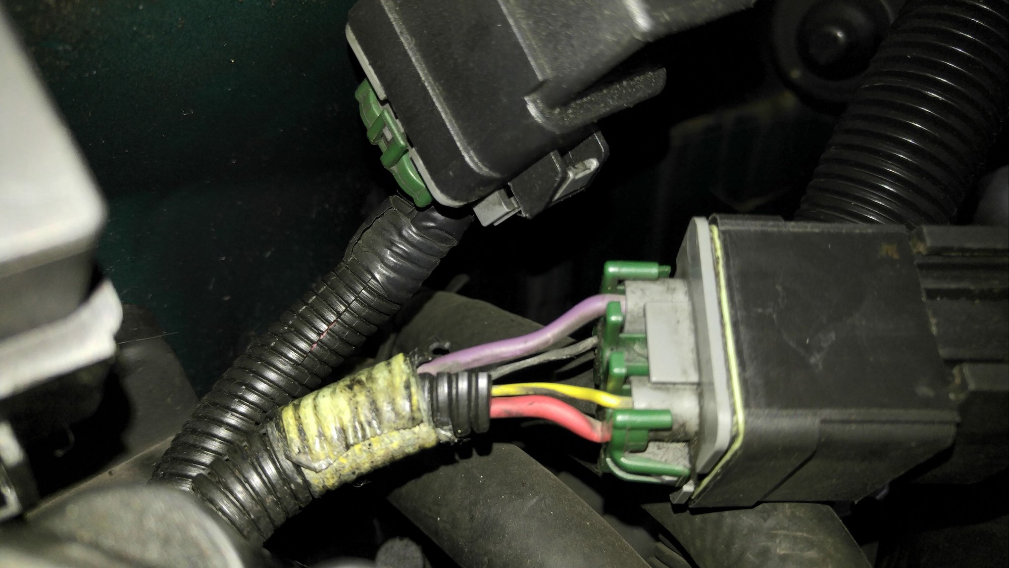

The relay has 4 wires, red, purple, yellow and grey.
Thanks for the tips, I took some voltage measurements at the yellow wire to the starter relay, even in start or run I get 0 volts.
What is the voltage on the purple power wire at the starter with the ignition key turned to start? Still getting to that one
What is the voltage on the relay coil (85)/purple/white wire with ign sw to start? what is the voltage at the power input to the start relay contacts (30)/red both before start command and during start command? Red wire at relay has 12V, there is no purple/white wire, but the solid purple has 0V.

97 Chevy Blazer starter relay
