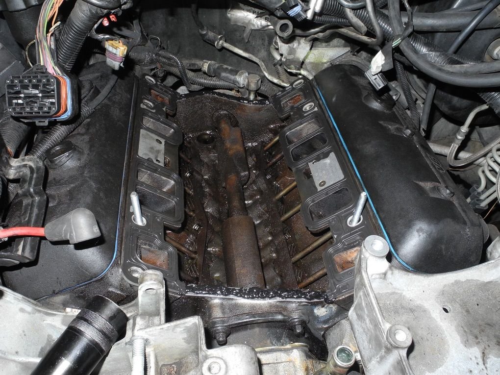

Old Jul 11, 2021 | 07:26 PM

George...what is the shaft with the offset shapes running right down the middle?
Balance shaft
George
Old Jul 12, 2021 | 07:59 AM
GrandpaDan's Avatar
Joined: Jul 2018
Posts: 42
From: Northern Wisconsin
GrandpaDan is on a distinguished road
Thank you, George!
Now I get it.
