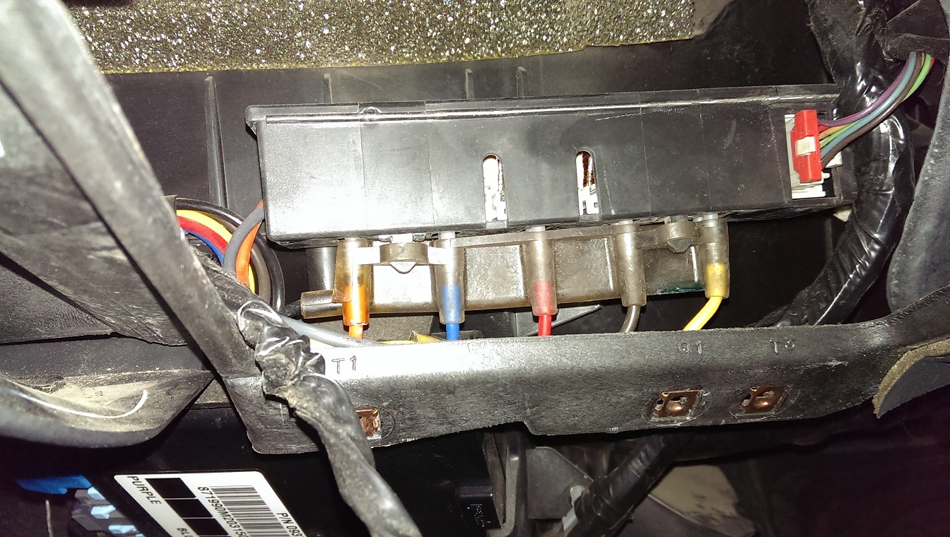

So I got energetic tonight and decided to take another stab at it. Evene with the truck off, there's plenty vacuum on that upper actuator - it's hard to extend out by hand.
I disconnected it from the white door level - that door is intact. I can move it with a little effort since I left the spring on it. I can hear the door opening and closing - no binding.
So good news for me is the doors are intact. What now...this thing maybe?

unpredictable1: where is the photo above taken from? What year S10 Blazer? What does the HVAC dash controls look like?
That's a pic from my 01 Blazer LT with the auto climate HVAC.
That there is what's behind the pull-out ashtray and is some sort of master vacuum control unit.
Not sure my HVAC controls could be leaking, there's just an electric harness that goes to that.
EDIT: With all due respect to TheJuicer, I'm not meaning to hijack but there seems to be tons of knowledge in this thread and you just might have the best collection of info in here. Cheers!

Ive repaired that electronic vacuum manifold on other vehicles before, in Grand Prix's they would get water in them somehow, theres a tiny rubber valve stuck to the end of a steel rod that slides through a coil, basically a bunch of solenoids controlling vacuum valves, the rods corrode and rust and would get stuck. I dont think water would be a huge problem in the location its in in the blazer, but maybe smoke tar and ashes could cause problems?.....if the vehicles been smoked in? Otherwise im sure those solenoids go bad too.
This is the big difference between manual and auto climate control, instead of a manual switch that physically routes the vacuum where it needs to go.
You can find the vacuum diagram and Connect a peice of hose to each port one ata time and put pressure or suction to it with your mouth and select different directions and see if the solenoids are doing thier job.
If you decide to dismantle the valves, be warned, you should do it in the bottom of a plastic tote or a box or somewhere safe, each valve has a very small lightweight spring in it and they wont work properly without, they dont come flying out or anything but you dont want to be searching for them on the carpet...trust me...or you can NOT be a cheapskate like me and just buy a new one, its like $60 from rockauto.
What is that part actually called? If I can see how to get it out - I'd just replace it. I'm grasping at straws now that the doors are intact and my actuators open and close/extend. (edit: I think I found it, HVAC Control Vacuum Control Valve ACDelco GM Original Equipment 15-72182)
Other than that piece, or the HVAC controls itself ...I'm not sure.
When I removed my HVAC control panel, there was black electrical tape along the seam at the bottom. Where the front black plastic meets the white plastic - almost like it was opened before...weird. But I'm not sure how that piece could be at fault.
