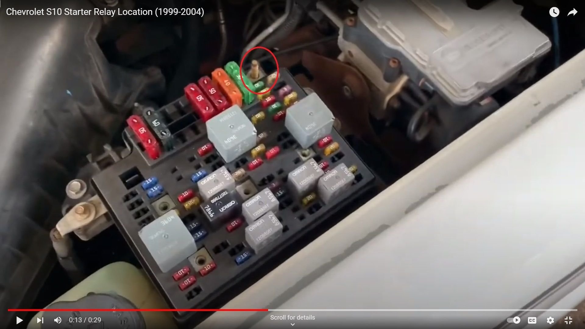

Thanks again. I have another fuse block question. n I've attached a screen grab from a YouTube video because I don't have a picture of my fuse box, but what is the circled post for? I thought mine might be missing a nut, but I see that this one is also without a nut. I'm guessing trailer brakes?
Just wondering why it is all alone with no nut. I though initially this might have something to do with the ground, but I suppose not.
