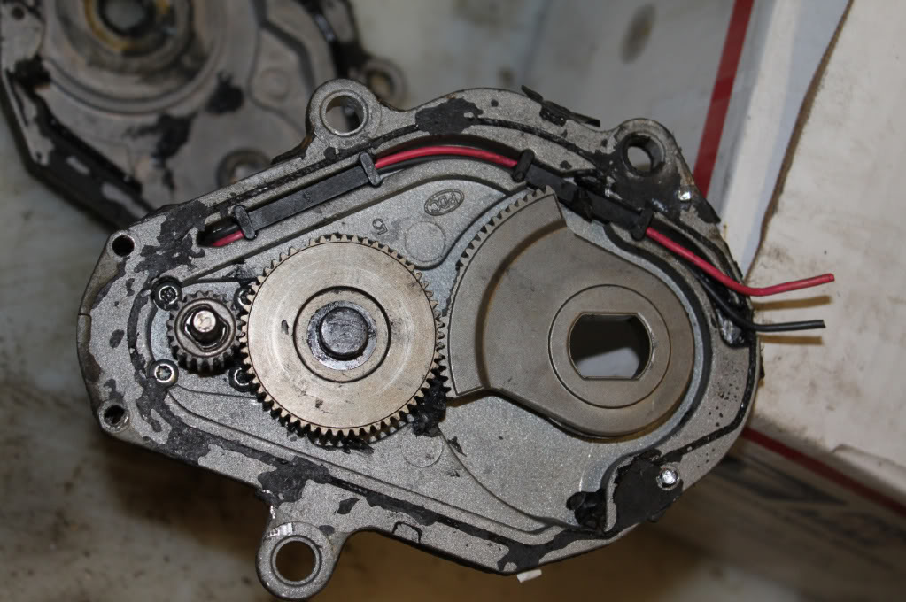

If you find that the transfer case moves well between detents, then the encoder motor may be the problem. If you are careful enough, you could pull the encoder apart and have a look at the gears inside. The attached picture shows the internal gearing of the NV233 encoder motor, specifically a failed unit where the final drive sprocket has stripped teeth from either a manufacturing defect or an issue with a shift that sheared the teeth.

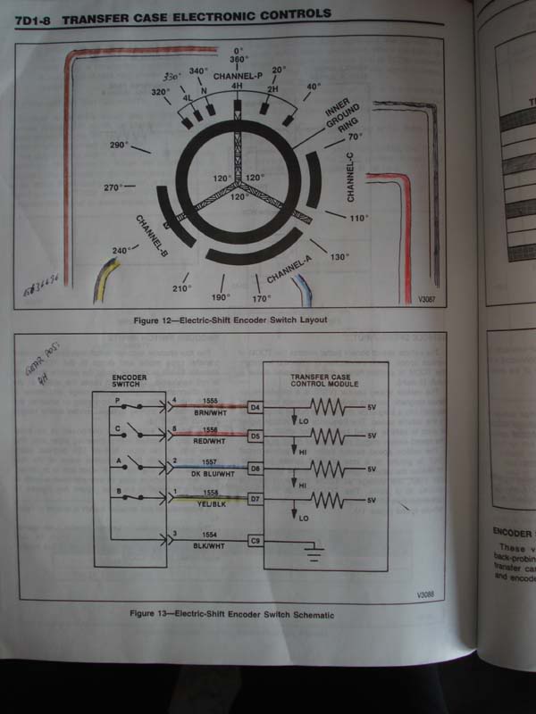

You could also back-probe the connections for the channels from the encoder to see if it is rotating through its proper range for the shifts. I have also attached the FSM section describing the encoder layout and associated schematic.
