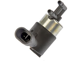

In 4WD it should have vacuum. In 2WD there should not be any vacuum on the diaphragm of the actuator. If it's sucked in, (in 2WD) that's why the front axle remains locked in. On your 99 there should be an electro-vacuum switch, just about center of the firewall, under the hood. Looks like this:
With the engine at idle, 2WD selected, one port of the switch should have manifold vacuum. The other port goes to the actuator and it should be vented to atmosphere. In other words, you should be able to blow & suck on the port with very little, if any, resistance. When 4WD is selected, the 2 ports are connected together inside the switch, which will apply vacuum to the line that goes to the actuator.

Yes. At idle, 2WD selected, remove the vacuum line that goes to the actuator, there should not be vacuum at the port on the switch. Then select 4WD, there should now be vacuum at the port. Post your results.
