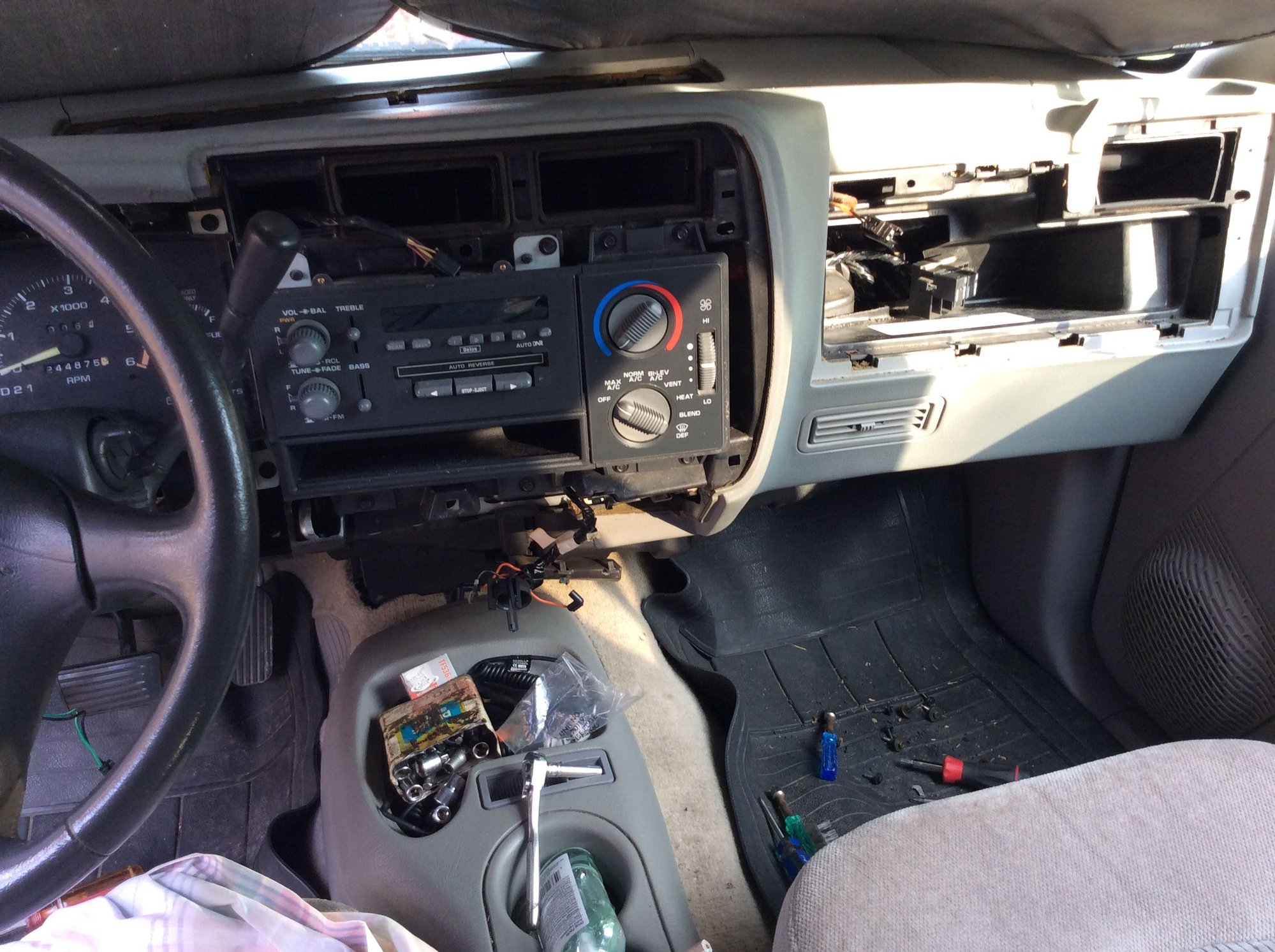

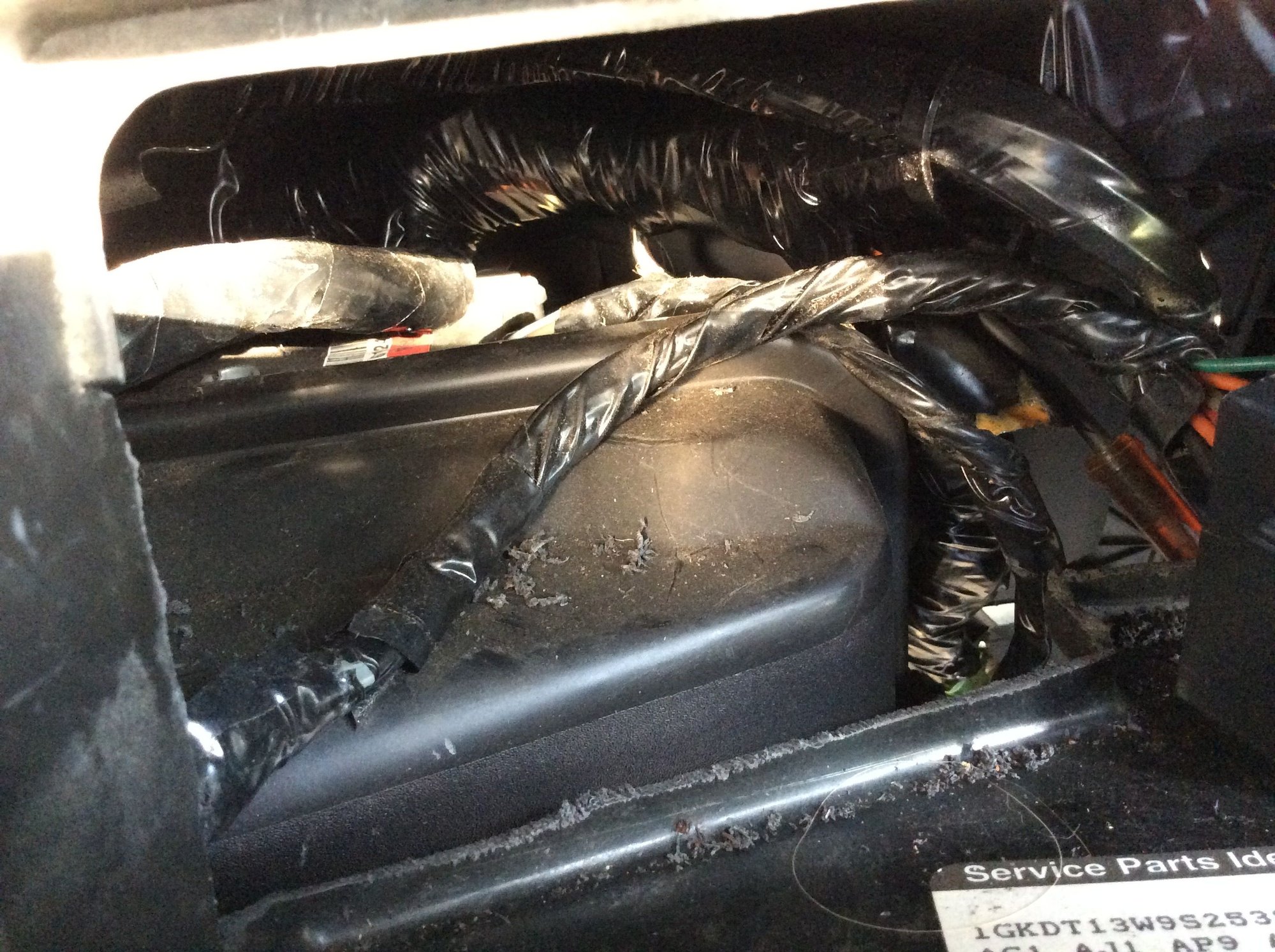

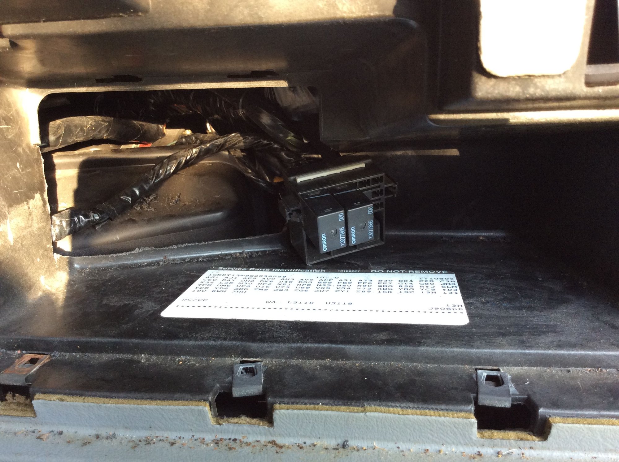

Yup, I check the blend door actuator, I watch it work, the dial works the inside air/outside air door on the passengers side low down. The vacuum door behind the radio operates open/shut....there's great vacuum to these two units....I replace under the hood vacuum line with new......
so, where's the actuator that's NOT closing the defroster vent to vent air????.
I'm going nuts trying to find a diagram of this stuff!!
Behind the glove box pictures....

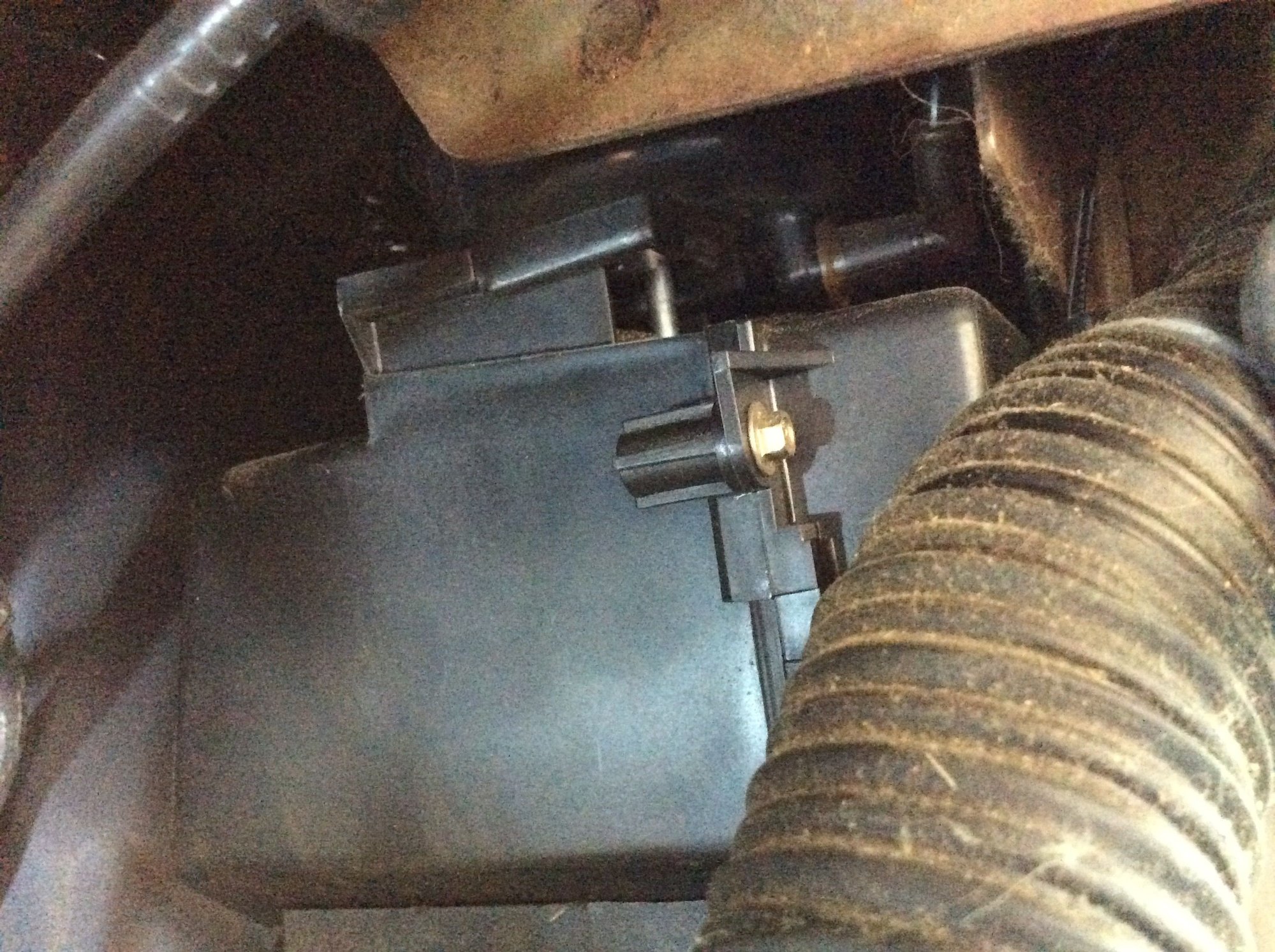

Yes! This may be it, I removed more screws/ bolts on the drivers side this morning....found that dashpots/actuator you speak of....and when I cycle thru all the choices, all the doors work, except this things rod never moves....and it's hard to get to.
im not sure how to get to it, or how the dash come out....time to search the web, and stop at the local Chevy dealer....
they may be open Monday. Surely there's a way to fix it.....if I have to disassemble the jimmy to get to it....you can be sure I'll go 1970's....and put a manual cable on it....like I did the 4 wheel drive....stupid engineers....electric to vacuum to mechanical.....😖
thank you you for your help.....I'll update the sad saga...Marc

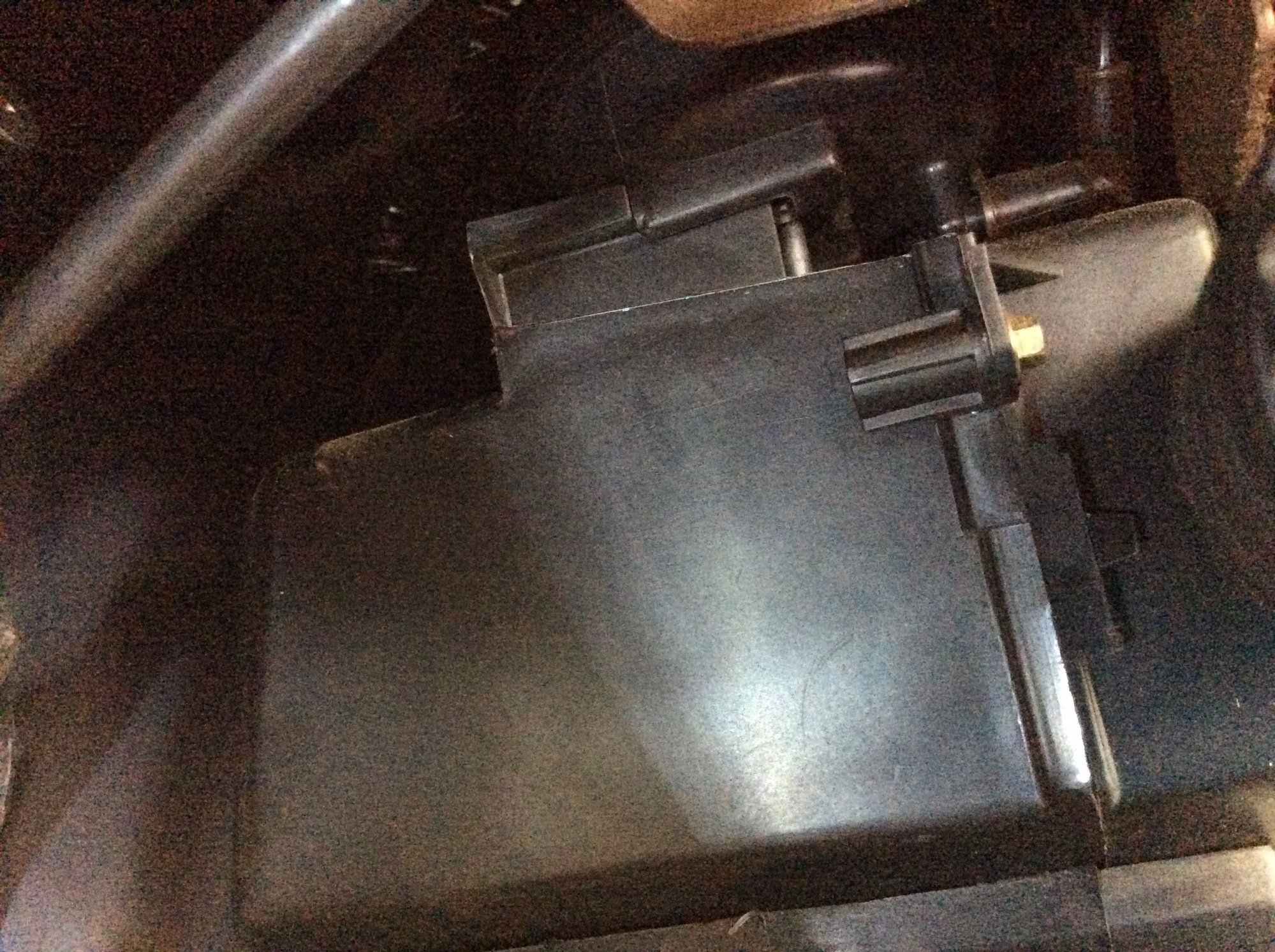

Here is a picture of what I am referring to, The lower actuator is the one that controls the defrost valve. The white shaft coming out of the air box is the defrost valve...which is really just a flap. I have a new one in a box if you want a picture of it.

Took the dash out completely....and it's heavy!!!...anyways tested the one actuator, it is working. It may be the 'switch' that uses the vacuum, but the part is expensive......so I put a balsa block and MADE it push out the ac vents😡
I got the dash back in, but will need a few mornings to reassemble the jig saw puzzle back together.....
No easy way to do this....but at least i understand the system now...
