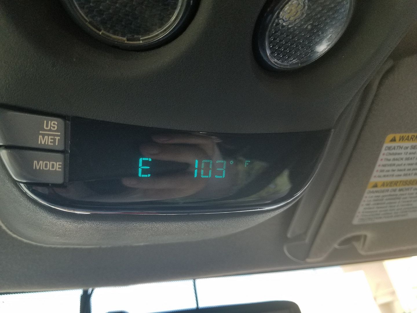

Trust me, I wish it wasn't actually 103 lol

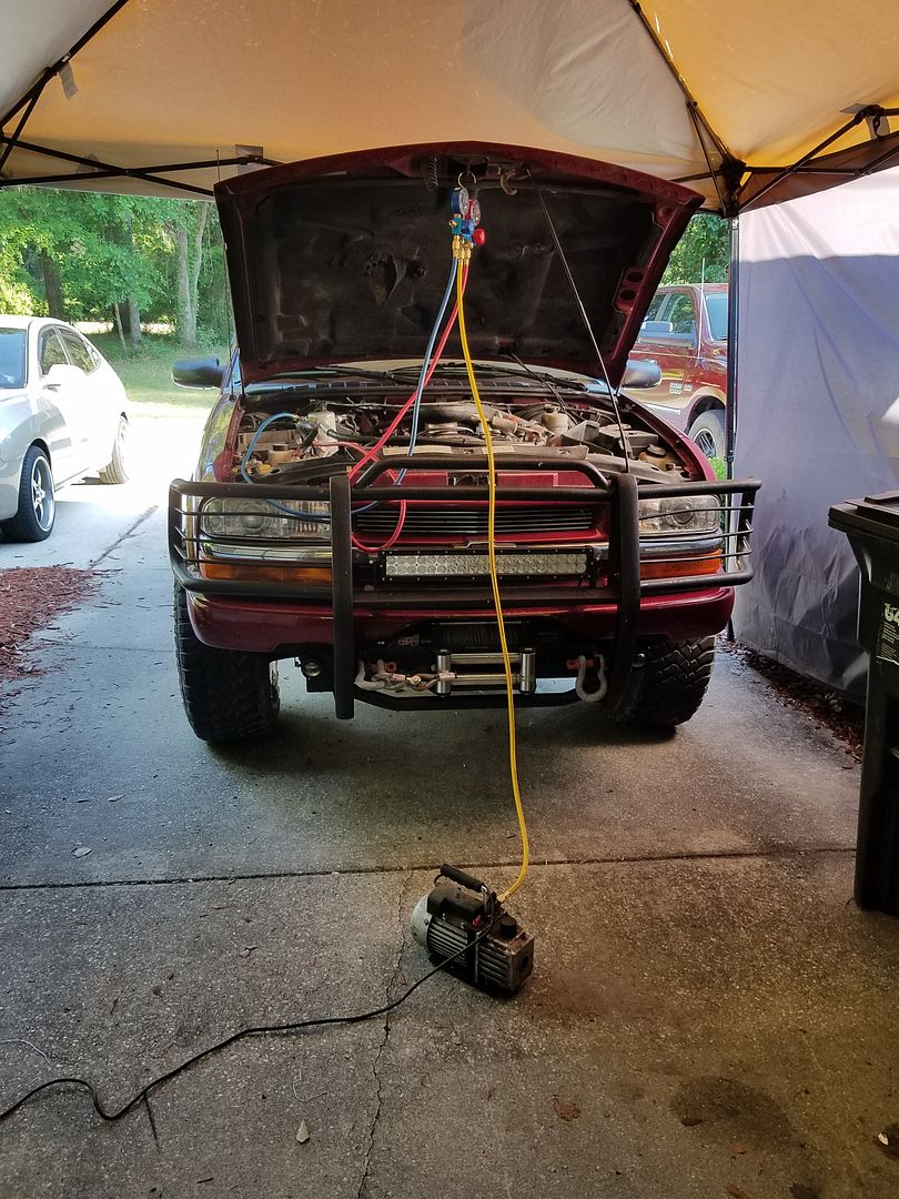

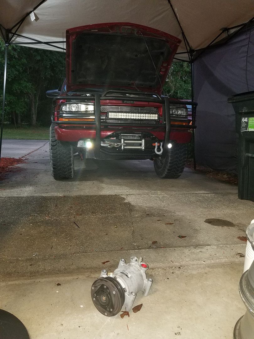

Well I believe I got to the bottom of the issue. Looks like the compressor was in the middle of taring itself apart from the inside and the orifice tube was partially blocked up. I also think there was WAAAAAY too much oil in the system. I bet there was 12-14 ounces of oil in the old drier when I removed it alone. I'm sure that wasn't helping cooling performance...
So over the past few days I've sucked the freon out at work, got a new drier and orifice tube and seal kit, and today I picked up a couple cans of flush and flushed out the evaporator and the condenser and the lines, and then bolted on the spare compressor I've had stowed away in the garage for a couple years now just in case something like this were to happen
(now I've got to restock my "warehouse" lol). I'm literally typing this up on the shop computer while I wait on the vac test. That's right. I borrowed a buddy's vacuum pump, and by golly I'm doing it right this time gosh darnit lol.
Got about another 10 minutes to go, so far it's holding vacuum strong, and then I'm going to run the pump for 45-60 minutes while I eat dinner, then come back out and charge the system with freon and see if I can get some cold air!

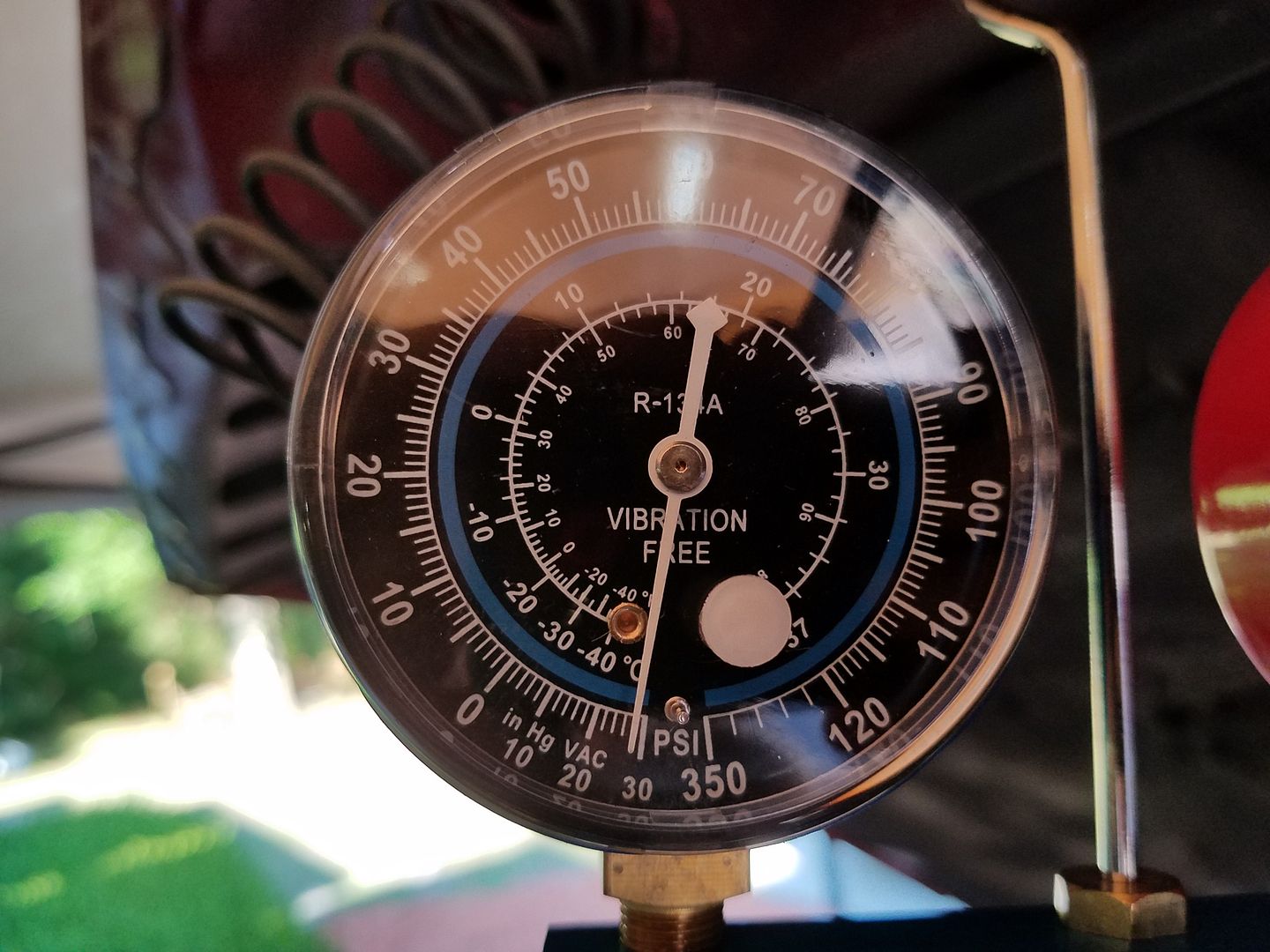

Well after the vacuum pump ran for the 45 minutes, the vacuum in the system dropped down to just below the 30 tick mark. I closed the valves and shut off the pump and I let it set there and the system held that vacuum level for a little over an hour and didn't budge, so I was satisfied with that result.

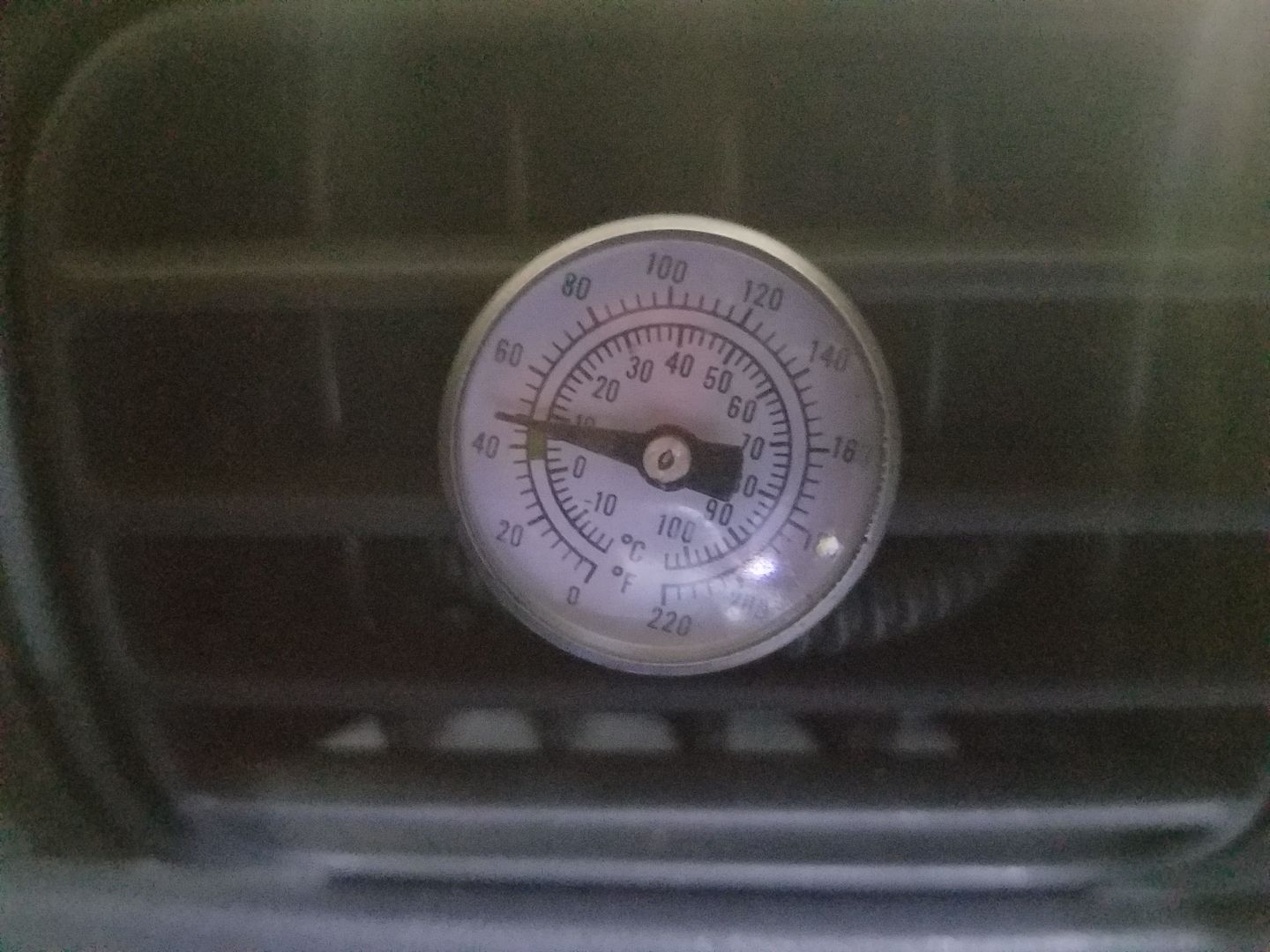

I shot some r134 in her, getting the pressures where the need to be (was dark and the outside temp had dropped, so I'm going to check again tomorrow afternoon when it's still 100 out and see how it's looking), and I'll be darned if she's not cold again! Ambient temp about 87-88 degrees at the time (yes that's "cooling off" here in Florida this time of the year lol). When I got in the truck to leave work today, the same gauge read 120... NOT TOMORROW GENTLEMEN!
