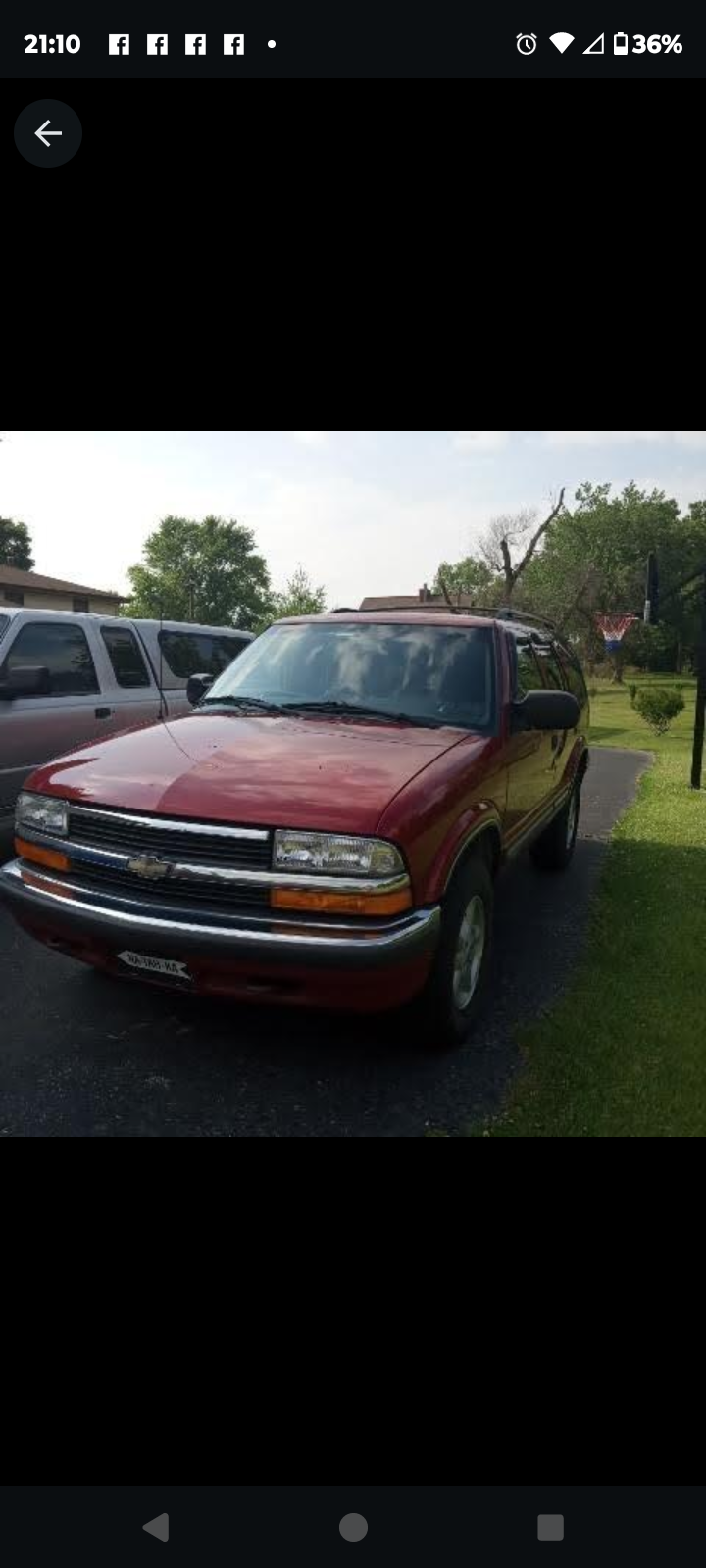

Hi
I have a 1999 Blazer. For the last year I've been trying to trace down that parasitic drain. If I drove the vehicle every couple of days it was fine, but, if I let it sit for several days I would have to jump start it.
It had an aftermarket, (Dealer installed), keyless entry/alarm. I put a meter on it and that was the drain. I just ripped it all out yesterday, wait and see now. Lost the use of the key fob remotes, I just going to resort to old school and just use a key to get in. The electric locks still work from manual controls inside.
My whole point to you is even though you have GM remotes, it may still be the aftermarket setup. Hope this helps. Let me know if you need anything else.
Later.
🐝 Stosh
