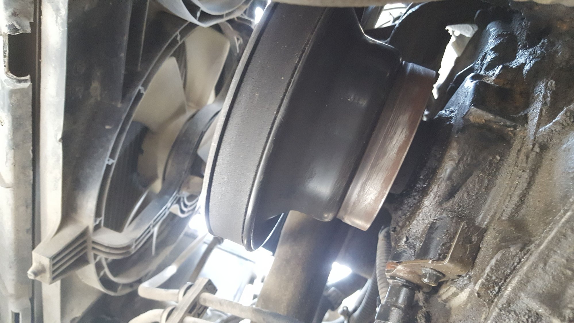

you can see no grove and I clean it
I also turn the pulley full turn but, there are no marks on it and all surface is straight when I touched all around the balancer

Looks nothing like my 02 blazer. Noticed you have electric fans, don't recall that being an option. Seems as though somebody has made some modifications from factory equipment. It looks like there is a balancer there but I have never seen one without timing marks. Do what mike.308 said and that should get you back running. One thing to note is that when you pulled the distributor to begin with there was probably residual pressure on the oil pump (this is why "the distributor changed"). When you lifted the distributor out of the pump the shaft rotated a bit. In most cases before reinstalling the distributor the pump shaft has to be turned back so that when rotor lines back up to your original mark the pump drive drops into place. So when you do as mike said the distributor probably won't want to drop into place until you turn the pump drive a bit. Hope this helps and keep us posted, we will help you figure this out.

Looks like the outter portion of the balancer came apart id start with a new balancer

Id be willing to brt that at some point the elastomer that holds the two parts together separated and someone removed the busted half since the pulley bolts to the hub
This. Even if you can get it timed, you should still replace the balancer.
