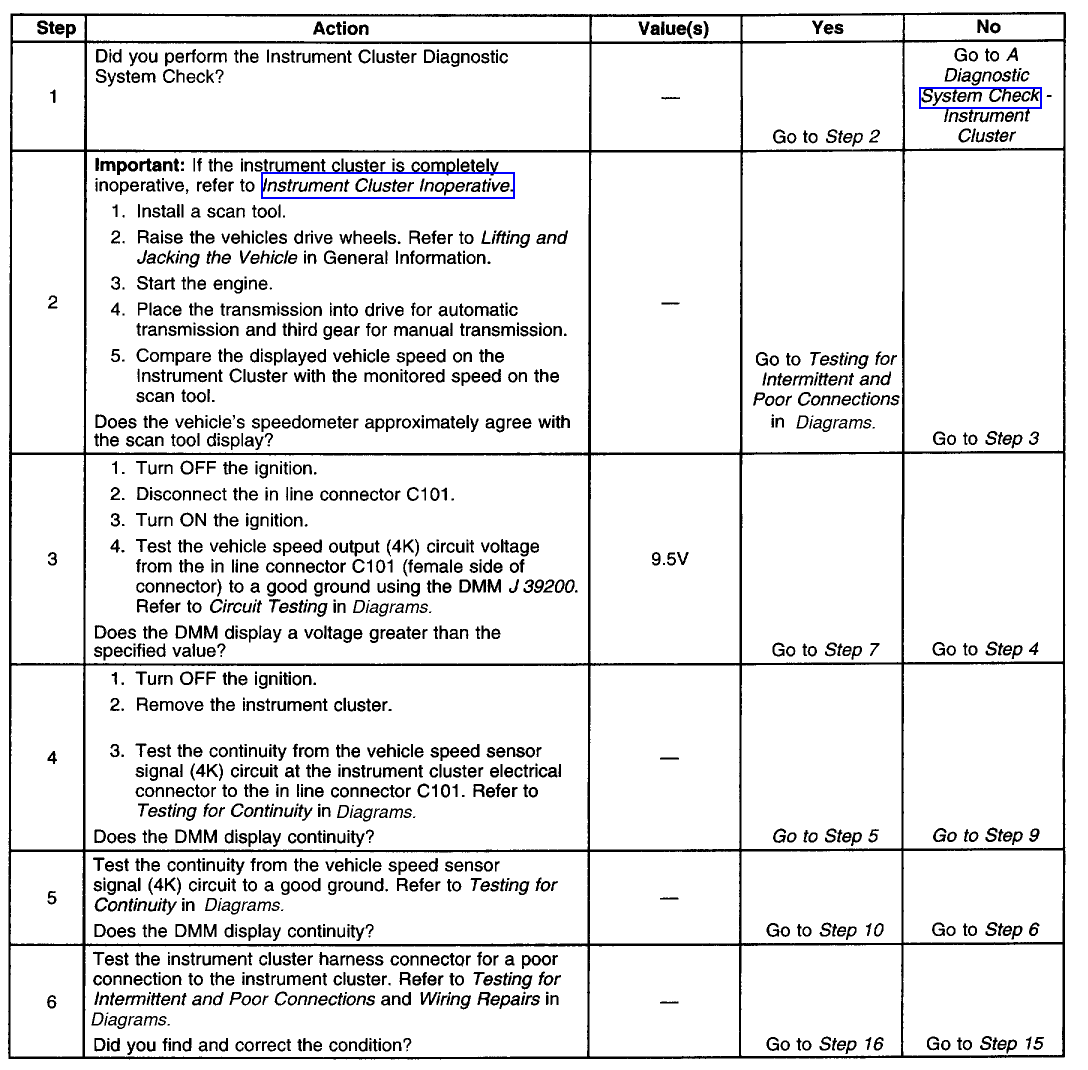

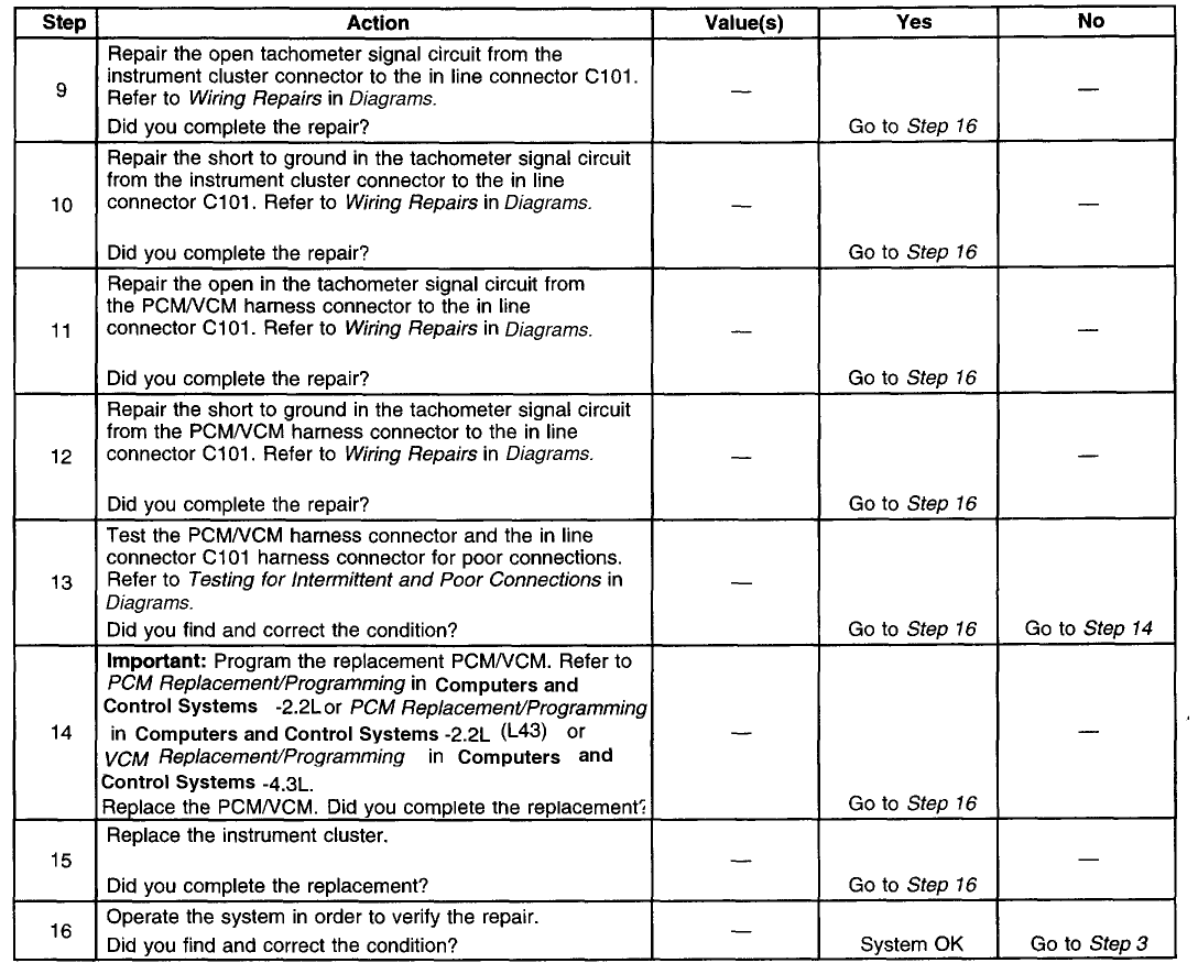

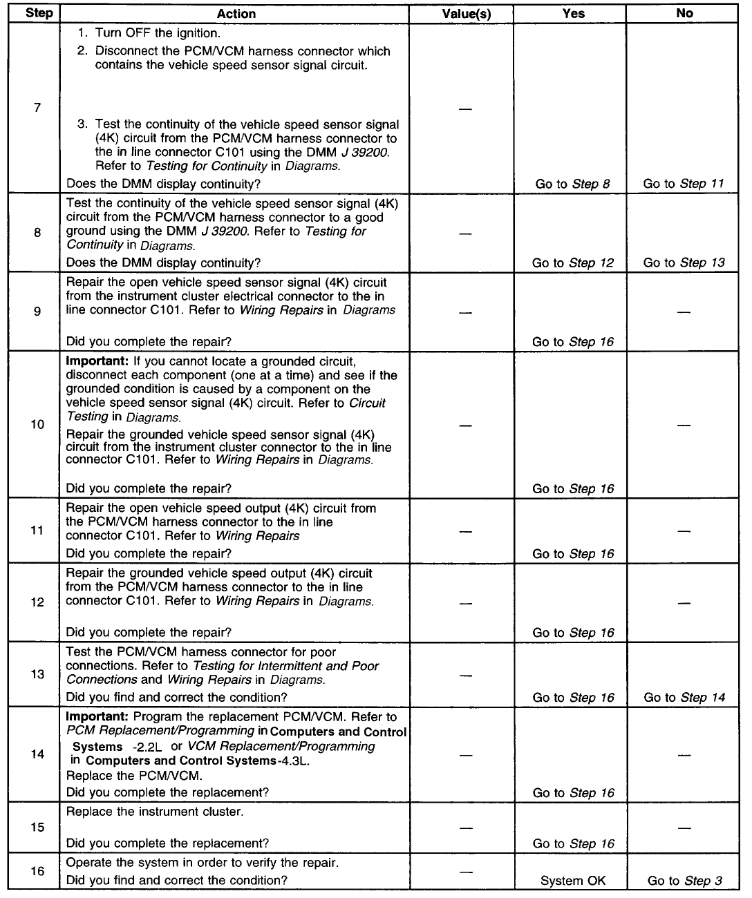

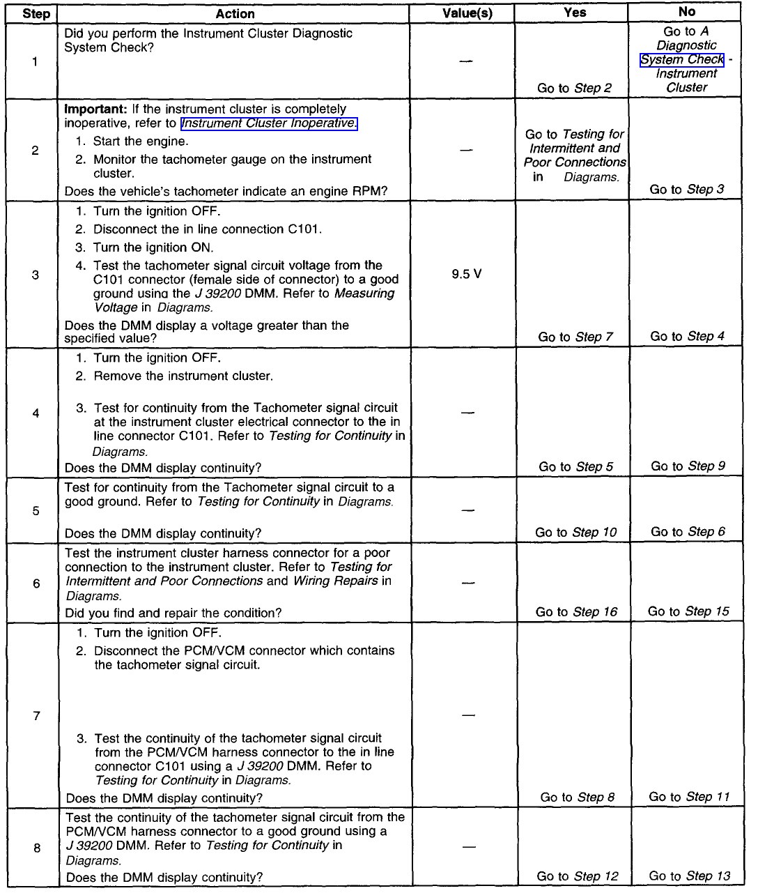

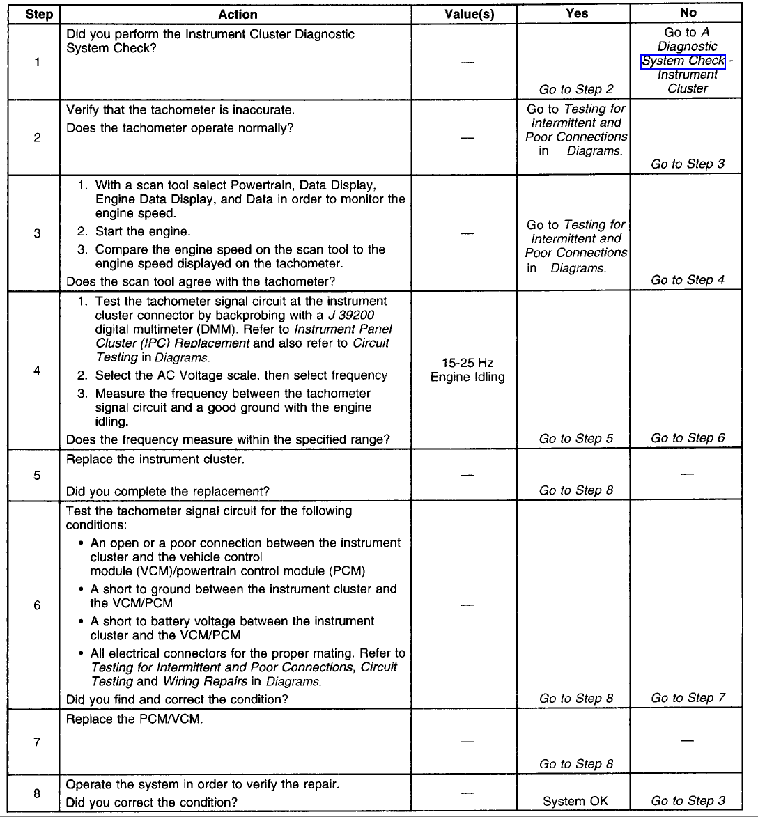

Below you will find some of the diagnostic charts regarding the tach and speedo. I am not sure if they will really help you much, especially if they require a bi-directional scan tool for some of the diagnostic steps, but they may offer some insight as to what might be causing both of these problems. I guess just look for some similarities.
Inaccurate Tach:
Inoperative Tach:
Inaccurate or Inoperative Speedo:
