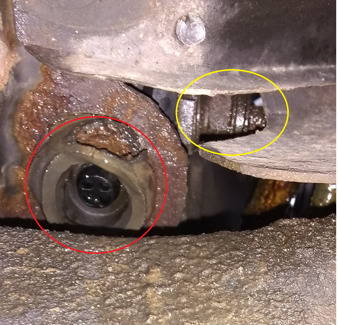

what am I looking at here? driver side under side corner. rubber grommet and rusted crumbled steel leaking without engine on without pressure. directly next to plastic skid plate for remote oil
Ya like my dry t-shirt creeper slider?

That be the drain plug.

Don, lol, niice. draining yes, plugging maybe not so much 😒. Christine, Rodger that. my shifter is on the floor I don't think I have an overdrive off button so I guess I just have to put the selector in D.
The thing in the red circle is a large grommet that accepts locator pins on the underside of the radiator. If the grommet has become damaged, then the plastic of the radiator could come into contact with metal and stress it enough to crack it.
The thing in yellow looks to be one of the oil cooler line connectors.

my parents leaked there, tried replacing and found the casing around it was cracked and leaking.
swapped out with a new rad, and good to go...
