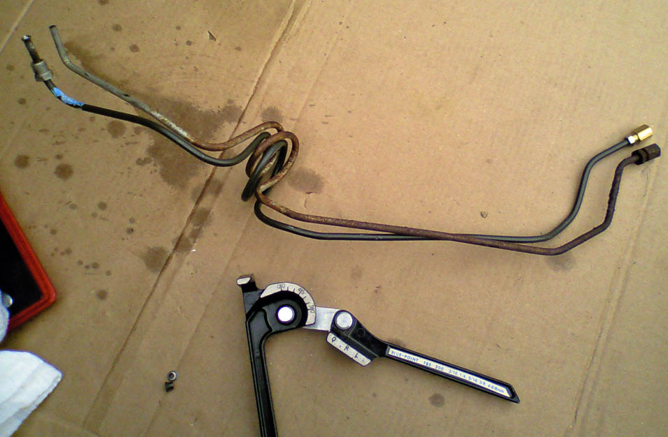

On my '98 Blazer 4x4, the front reservoir is the rear brakes. Mine leaked just under the firewall, on driver's side. Line rotted on the frame rail. I replaced that full section with three separate pieces, from firewall to rear axle.
Also replaced the vertical pipe that goes from the ABS (?) and the horizontal line on the frame rail. Took a while to hand form the spring-coil section. Had to re-use the flare fitting at the ABS (and flare the pipe).
