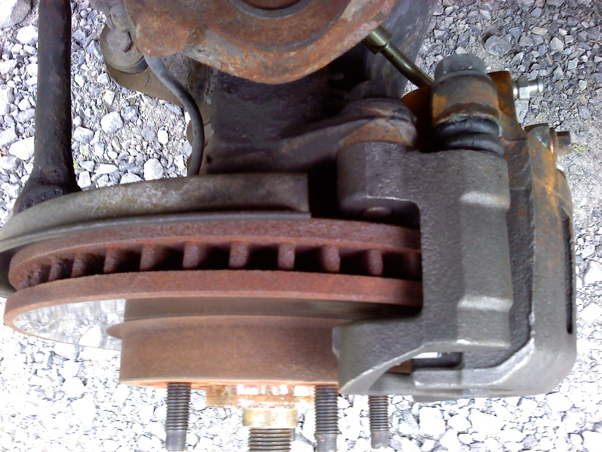

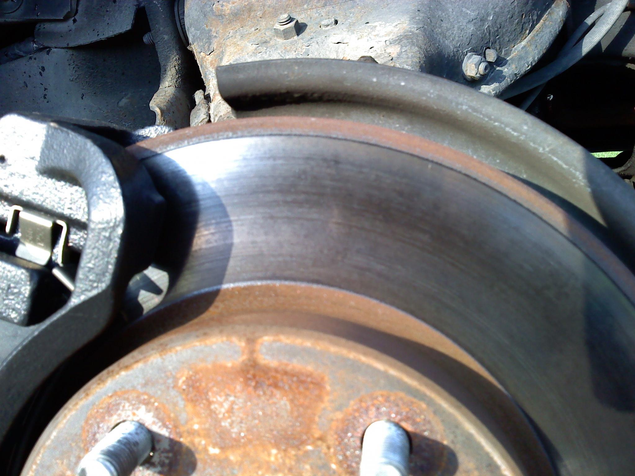

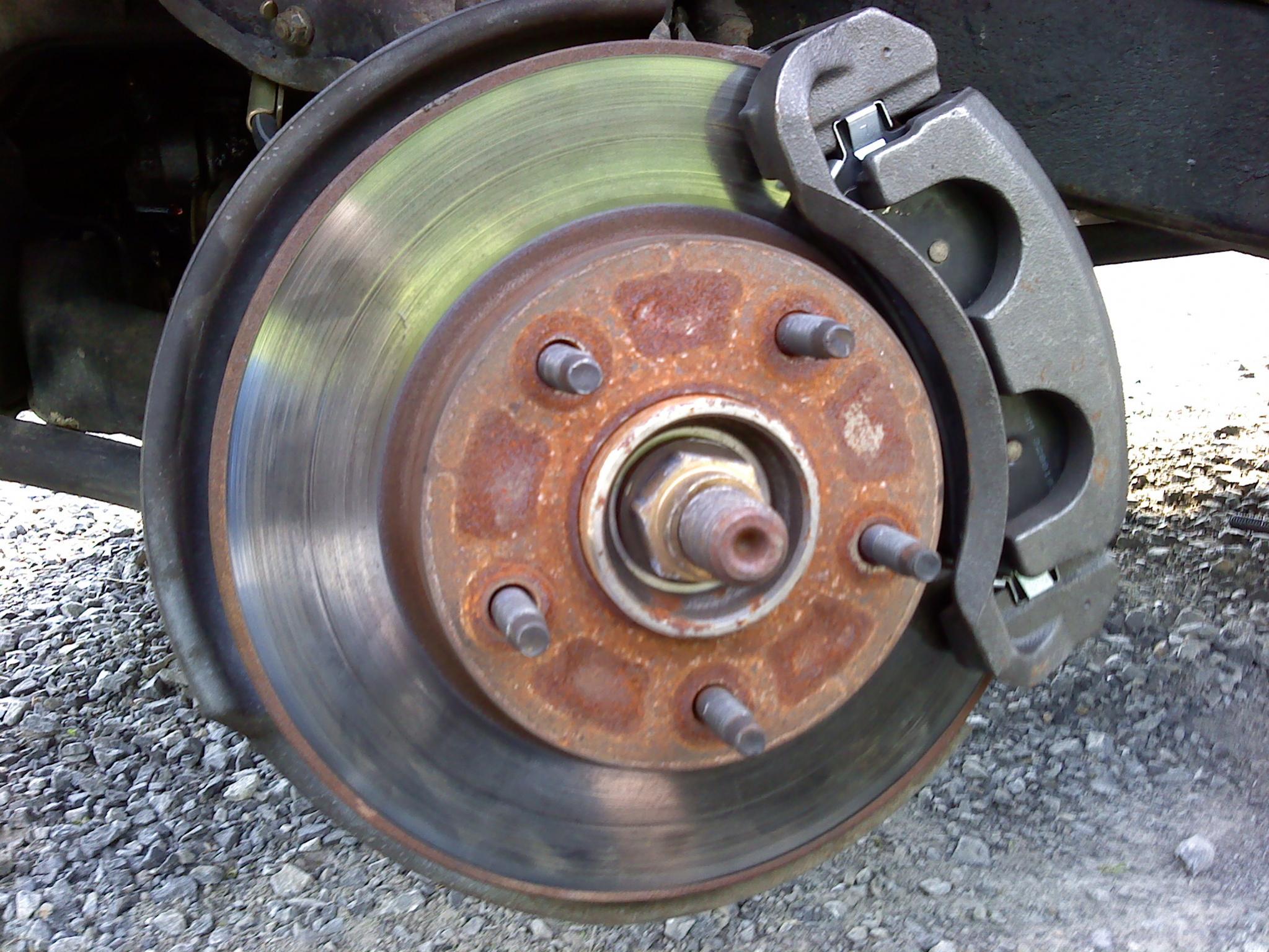

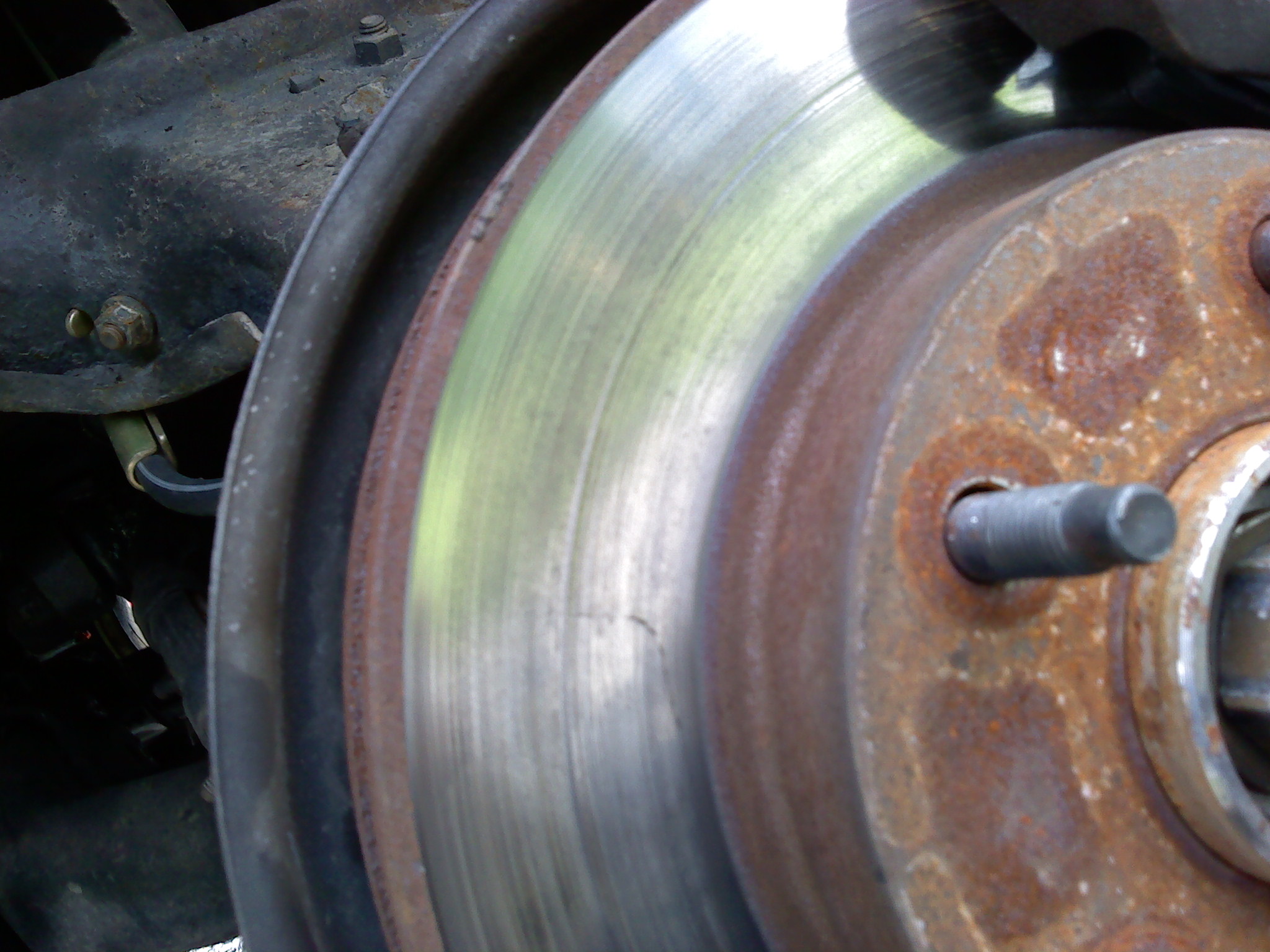

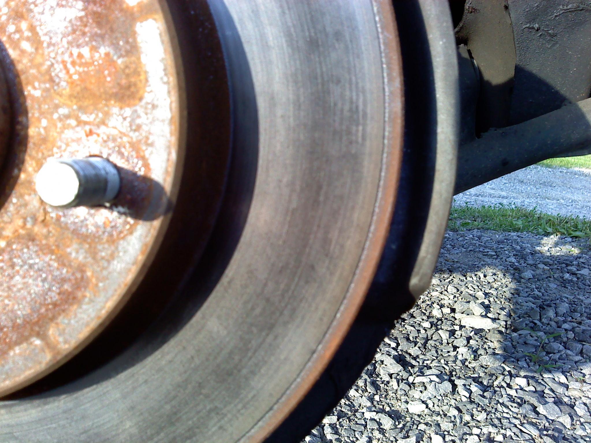

There is definitely something wrong with the rotors. I pulled the front wheels. The driver side looked normal except for some deep (I can feel it with my fingernail) scratches. The passenger side rotor was covered in some black junk all over it. I also had trouble rotating both wheels smoothly. The passenger side seemed to be the worst. I am posting photos of both brake rotors for advice. I think these are cheap rotors. I can't find any air holes in the center and I can't see any other air cooling fins other than what is on top. It seems completely hollow once you get past the 1" long fins on top. I wonder if these are the lightweight rotors I heard about that have 20% less metal and are dangerous. Please see http://www.badbrakes.net/ . The Napa Premium rotors for $28.19: ( http://www.napaonline.com/Search/Det...50030+2030009# ) Are they good? They seem to be alot cheaper than everywhere else. Am I asking for trouble? I just don't want to have to do this again in a year.
EDIT: http://www.aa1car.com/library/brake_rotors.htm <<<<CHECK THIS OUT!
EDIT: I don't know if this has anything to do with the rotors, but I can grab the opposite side of the rotor from the caliper and the rotor wiggles about 1/4" of an inch. It is NOT the wheel bearings (NEW). Do I need shims or something or is that normal?
EDIT: Is it possible to use brake parts cleaner and steel wool to clean the rotors of this mess until I can get new rotors? Which type of brake parts cleaner is safe to use around rubber parts?
Yes the rotors need to be replaced, deep grooves give less surface area for the pad to rest on thus giving you less braking. That is normal if the opposite edge of the rotor moves, all that holds the rotor on while the wheel is off is the caliper, you have to remove the caliper and then the rotor will come off, the wheel holds the rotor in against the wheel bearing when you tighten the wheel down.
I would go ahead and replace all the rotors with the napa rotors as they are a good rotor, or you can take the rotors you have and have them turned and smoothed out for about 11-12 bucks a piece, I would go ahead and get the new ones, and then take the old ones in sometime and have them turned for backups, just stay away from the light weight rotors they look like a disaster waiting to happen
