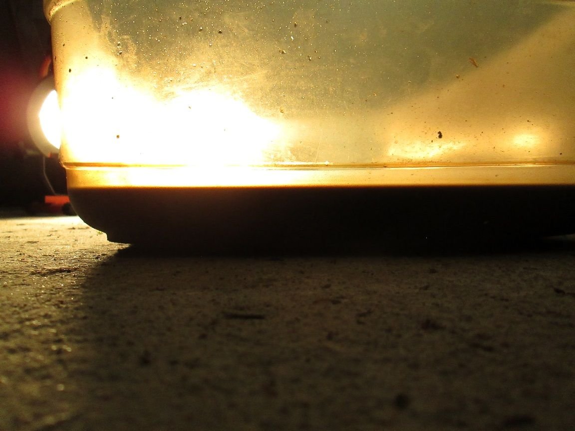

I did what you suggested and drained the oil after the truck was sitting overnight and the oil looked totally normal when I first took the plug out. I took this pic of the oil after it was sitting for several hours, I think if there was water in there the light would shine through, right? Thing is though, the coolant loss isn't that severe, maybe a quart every three weeks or so. Not sure if that's enough to make it obvious by looking at the oil.
I think I'm going to try to bypass the heater core, burp the system, and see if there's any change to the coolant loss/coolant temp.

That is interesting. I would think the oil would sit on top of the oil.
Pretty sure you meant the oil would sit on top of the water, and yeah that's what I thought too. I was cringing the whole time I was loosening the drain plug thinking I would get a gush of water, but nope. And I even left the oil in the drain pan overnight and inspected it and there still didn't seem to be anything abnormal about it.
