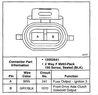

As stated before, you can test the wiring yourself. If you want to dismiss suggestions and have a dealer fix it for you, that is fine, but it does not change the fact that diagnostic suggestions were made and not taken. To make it a little simpler on you, the TAN wire at the solenoid should be +12V and connected through the IGN3 fuse in the fuse box. The Gray/Black wire should be connected to the F4 cavity on the 32-way connector at the TCCM. An easy continuity test can be performed to determine if the circuits are intact. Before I had stated that the +12V is what was switched. Prior to locating the connector views I have now, that was an assumption I had made based on typical systems. It now looks like the ground is what is switched. Here are those connector details:
Front Axle Solenoid:
32-way connector at TCCM:
A faulty TCCM is a theory, however, testing that is beyond the capability of what most DIY people can do. You can replace it, but you would be spending money on speculation alone. You can take the chance as it probably would be cheaper than having the dealership diagnose the problem.

Ofcourse, testing the wiring may not tell you if the system is functioning properly or not (other tests are detailed in other posts). I believe that when the TCCM commands a mode switch, the engagement of the front axle is the last thing in the process as things are verified. If the TCCM does not sense that the transfer case has been properly shifted, it likely would not continue on with the rest of the steps in the process.
I never said I wouldn't test the connector for power, it's just not so pleasant when it's below 0 or snowing and I don't have a garage (I'll be visiting my sister this weekend and I'll be using her garage for further diagnosis). The only question I asked twice was about whether or not a faulty TCCM would throw any error codes at all. If a bad TCCM can't throw codes, then there's no reason to suspect the TCCM since Chevy did pull the code for the switch. (Unless I'm misunderstanding something, the TCCM would be what records and sends error codes to a Tech 2 scan tool.) I'm not going to replace it just for the hell of it, I'm just trying to eliminate things to look at. If I can't find the problem this weekend with a multimeter (those diagrams help, btw), Chevy's only charging me $65 to find the problem... and I'll go from there.
