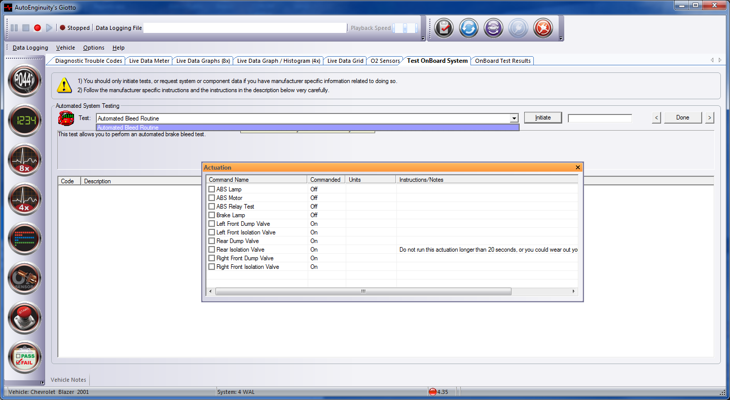

Yes, their cST06-USB with EI02-2 add-on will do it. Screen shot is below. I just ordered the set for $500.
