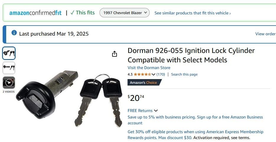

The ignition lock cylinder I bought was a Dorman 926-055 (see screen shot).

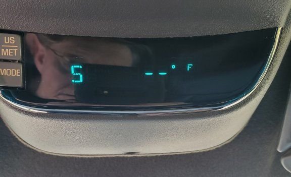

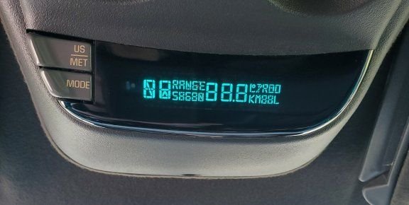

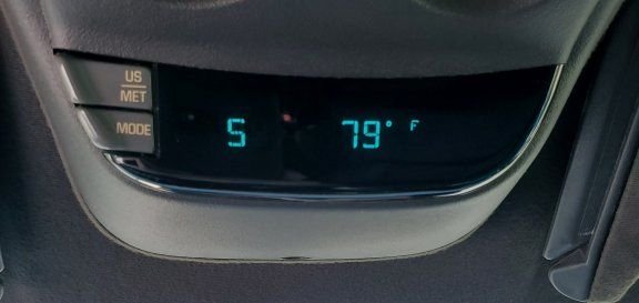

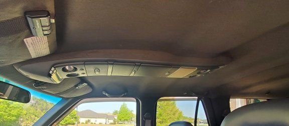

I found that the digital console display works sometimes when I start it - about 10% of the time. I'm beginning to think it may not be related to the replacement ignition cylinder. When it doesn't work, the temperature displays for a few seconds after starting, but then changes to - - ° F and the compass does not update as the vehicle changes directions. It displays the direction the vehicle was last facing when it was started.
Long console, no sunroof.
Display at startup.
Display at startup.
Display when working properly. Compass and temperature update normally.
Display when NOT working properly. Temperature not displayed and compass does not update as the vehicle turns.

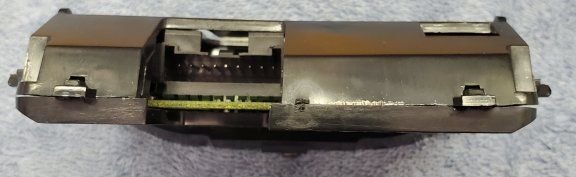

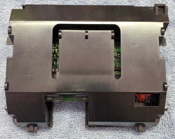

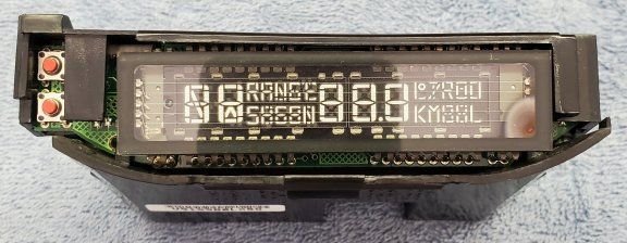

Looks like I need a replacement part number 12376609. This part is a compass, electronic (compass/temp/trip) (9 pinion connector). Can't find one on the internet to purchase (discontinued). Couldn't find one on eBay either. I may have to start looking for junk yards. Here are photos of the current unit.
