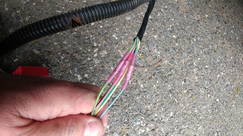

I pulled the fuse box today. I didn't find anything with the wires in the engine bay.
I found the light green wire in the red connector's harness. So I followed that and pulled it down through and out the bottom of the car and found this.
Pulled the heat wrap and split loom off, and look which wire was damaged. However, it doesn't appear to have gone through the insulation.
I had to call it quits because it started raining. So I tucked the wiring back under the car and cleaned up the tools. My plan is to cut the burn pieces out, repair it and put it back together to see what happens. It is supposed to rain again tomorrow I am not sure if I'll get to it.

I fixed the wires and put everything back together between rain showers today.
As soon as I hooked up the battery the backup lights came on. I pulled every fuse in the dash and they were still on. Also, the rear hatch glass still randomly pops open. I started the car and my security light stayed on and the gauges took about 30 seconds to come on. I turned the headlights on and it took them several seconds to turn back off. The engine doesn't stay on now, it starts and turns off fine with the key. So basically I fixed one thing and found 2 new problems. I guess this week I will pull the harness further back from where I had taken it out too look for more damaged wires.
