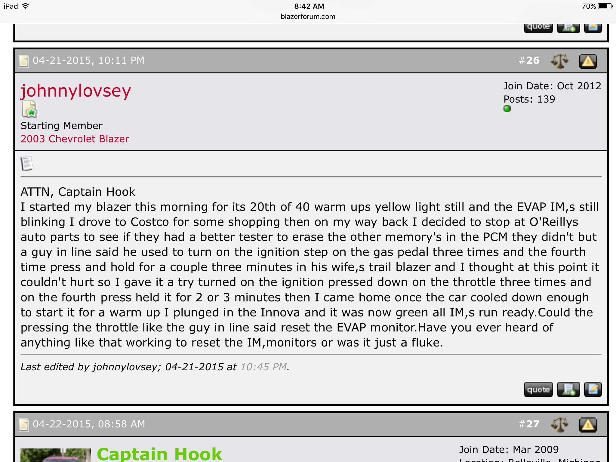

Have you tried the gas pedal thing again?? Worth a shot, but I'm not going to hold my breath
Thanks Les you have always been good at simplifying things oh and don't worry when I get my service manual hopefully I will be able to simplify those steps to where a DIY mech can understand them. And someone with a $2000.00 or more code reader so I can use most of what you put down.Those of us with $400.00 code readers don't have that luxury.OH yes and the GM dealer that said they would fix me up for $150.00 fixed a fuse eng 1 10 amp and told me maybe there was a leak and they would have to smoke it more money and drop the gas tank more money so far with gm dealership that told me $150.00 out the door evap fixed out the door has cost $220.00 and by looks of thing,s another $300.00 and then just maybe they can get me out the door for just around $500.00 thanks but no thanks but again thanks for all your help on the matter.
