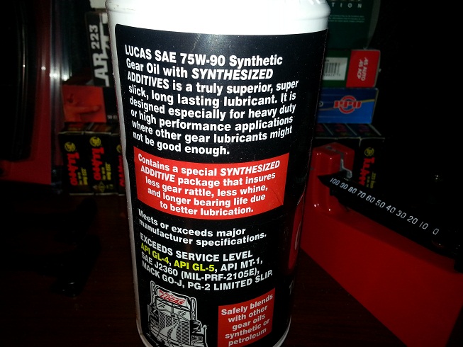

With the rear end I have, would this be a good oil ?
Anyone ever used this before ?

That would be fine. The manual calls for either 75W-90 or 80W-90. I've been told that the 80W-90 is better for a warmer climate, and the 75W-90 for colder, but you won't go wrong with either. I live in the frozen wasteland of Canadia and am running 80W-90 cause that's all I could find for a reasonable price. I am not an oil specialist, and the majority of my information comes from people on here, past and present.
