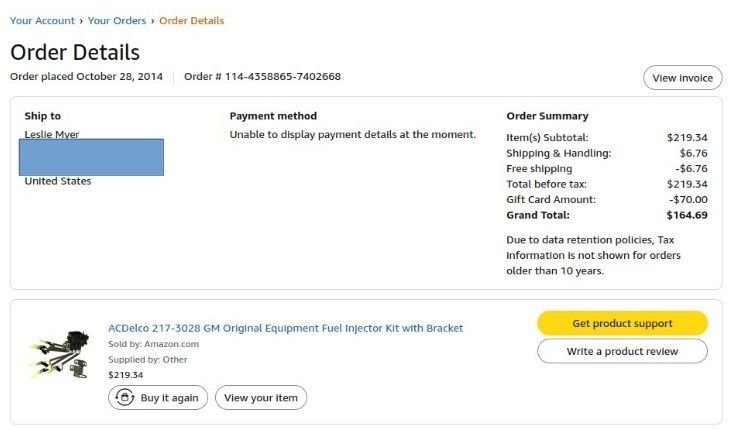

Lanny, all L35s in Blazers through 2002 model year had SCPI injection (poppet style) unless they were converted, 2002 was the first year the LU3 (MPFI) was available in the vans. 2003 was the first year LU3 (MPFI) was available in the Blazers. https://en.wikipedia.org/wiki/Chevro...2%B0_V6_engine
I have an AC/Delco MPFI spider that I bought back in 2014. Used it just enough to figure out I had an injector wire shorting on exhaust manifold after engine replacement - maybe few hundred miles and switched back to old MPFI spider as it had already been upgraded in the past. No mounting bracket or fuel line o-rings anymore (lost during the last 11 years). If you're interested, PM me and make an offer. I would always take it back minus shipping if it doesn't work out for you.
Would need o-rings from https://www.dormanproducts.com/p-6090-90000.aspx
Would need a GM bracket 88894355 (for a LU3) which is available. I would assume that is the correct bracket, since otherwise wouldn't need a replacement bracket for upgrading earlier vehicles. https://www.rockauto.com/en/partsear...rtnum=88894355

Christine: thanks for looking for me. I found the same, injectors available but no central unit.
George: I had misread the posting regarding MPFI beginning in 2002. They did, just not in the Blazer....as you posted. The NAPA unit was actually the first one I looked at. And yep, a tad bit towards the expensive side. I did find that Autozone lists a GM unit, 19210688....but it is almost $600! and has really bad reviews about it. Not going to spend that much.
Les: Wow!... that is a very nice of you! Sending a PM.
