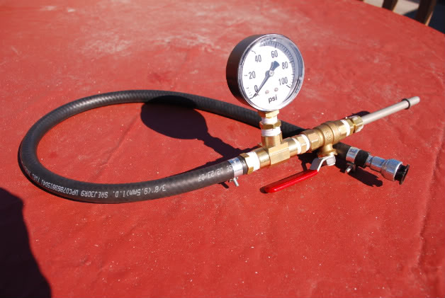

The only way to tell for sure where the excessive leakdown is coming from, is to isolate the pump from the plenum just after pressurizing the system. It's done with a tool like this:
The tool can be made for around $40 with parts readily available at a good plumbing store and an auto parts store. Without isolating the fuel pump, it's a guess as to where the leak is.

Yeah I have a regular fuel pressure test kit but Ive been thinking of ways to isolate the fuel pump. Where do you hook your contraption into? The fuel filter?

Yes, it connects inline at the fuel filter. This particular one is for 96 and newer. They use one quick connect fitting at the filter. 95 and older doesn't have quick connect fittings so it requires different fittings to adapt to the fuel lines.

Yeah the 95 has the "bolt in" filter. If I have to build one I will but I really can't spend the money as of right now. Ive been thinking back and I think I know what is causing it. Off to start investigating

You can remove the plenum and look for a leak while the pump is running, but that only eliminates a couple of things. You can remove the injector nozzels and watch for leaks as well, but without the shut off valve, you can't diagnose an internal leak in the fuel pressure regulator, or anything in the tank.
