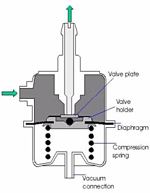

If the pump holds 70psi for 10 minutes, fuel pump leakdown is acceptable. If it drops below 40psi at the service port, there's a leak, either internal or external. If the engine is not flooding on a hot soak, it's probably not the injectors. If there are no external leaks, the only thing left is an internal fuel pressure regulator leak. There is only one [safe] way to test for it. Install a shut off valve in the fuel return line. With the valve open, activate the fuel pump to pressurize the system. The instant that the fuel pump shuts off, close the valve. If leakdown remains above 55psi for at least 10 minutes, fuel is leaking past the valve plate in the regulator. Caution: DO NOT activate the fuel pump with the valve closed. If the regulator diaphragm is exposed to ~75psi or more, the diaphragm can/will rupture.
