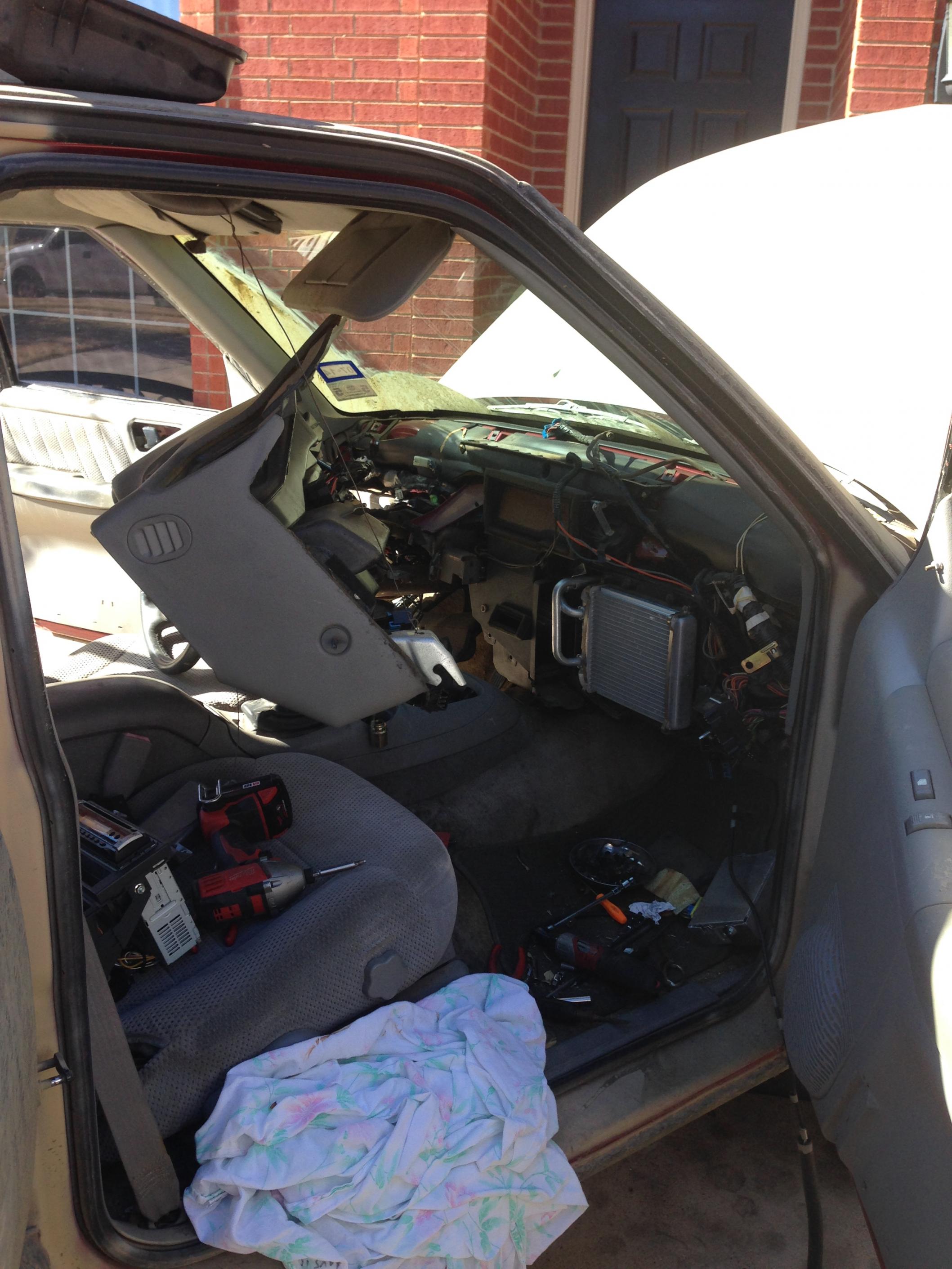

yes. have to pull the dash to replace heater core. takes about 5-6 hours to do.

Pulling the dash is really not all that difficult. Just need to remember where all the screws go.....and do not forget to pull the dash speakers out and the screws under the defrost vent.
