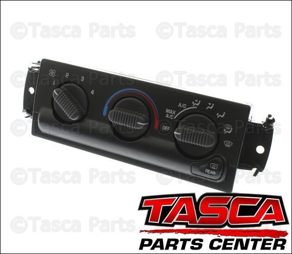

I know there are two different control units, I have the same problem with mine. Had all heat loss but everything worked. For me it was the control unit itself, the temperature adjusted on it was the problem. Swapped it out and I had everything back. I dont have the truck with me today, so I cant send a pic of what I'm talking about. Just in case your confused, im talking about the controls under the stereo lol.
I have a brand new one that in storage that i cant use. Willing to get rid of it at shipping costs if you need it.
Old Jan 10, 2019 | 09:51 AM
Part in storage
Part in my truck.
the center **** was my problem...
