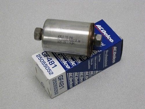

Adapters for testing maximum fuel pump output pressure and leakdown:
If your fuel filter looks like this,
you will need these parts:
QTY 1 Dorman #800-121 or 800-182 fuel filter connector. Available at most auto parts stores
QTY 1 1/4” MFL X 3/8” hose barb adapter available at:
http://www.homebrewing.org/SS-14-MFL-x-38-barb_p_3521.html
or
http://www.grainger.com/product/THOGUS-Male-Flare-Adapter-4HFJ2?functionCode=P2IDP2PCP
QTY 18” (minimum) fuel injection rated fuel line. Available at most auto parts stores.
http://shop.advanceautoparts.com/p/h-b-d-industries-fuel-injection-hose-pi-504/5194660-P?navigationPath=L1*14932%7CL2*14985%7CL3*15352#fr agment-2
QTY 2 Fuel injection rated hose clamps. Available at most auto parts stores.
http://shop.advanceautoparts.com/p/autocraft-3-8-automotive-fuel-injection-hose-clamp-4-pack-ac52f16v/89016086-P?searchTerm=hose+clamps
Total cost is approximately $30
If your fuel filter looks like this:
You will need these parts:
QTY 1 Watts LFA-116 1/4” FIP X 3/8” compression adapter. Available at Lowes or Home Depot
http://www.homedepot.com/p/Watts-3-8-in-x-1-4-in-Lead-Free-Brass-Compression-x-FIP-Coupling-LF-A116/202254848?keyword=lfa116
QTY 1 Watts LFA-80 1/4” MFL X 1/4” MIP adapter. Available at Lowes and Home Depot:
http://www.homedepot.com/p/Unbranded-1-4-in-x-1-4-in-Lead-Free-Brass-Flare-x-MIP-Half-Union-LFA-80/203468369?keyword=lfa80
QTY 1 Dorman 800-170 Fuel filter adapter line. Available at most auto parts stores:
http://shop.advanceautoparts.com/p/needa-parts-steel-fuel-line-repair-kit-3-8-x-4-with-16mm-clip-800-170/16140334-P?vehicleIdFromReq=40747&isAllVehicle=false&vehicl eIdSearch=40747&searchTerm=800-170&showTitle=
Total cost is approximately $10
