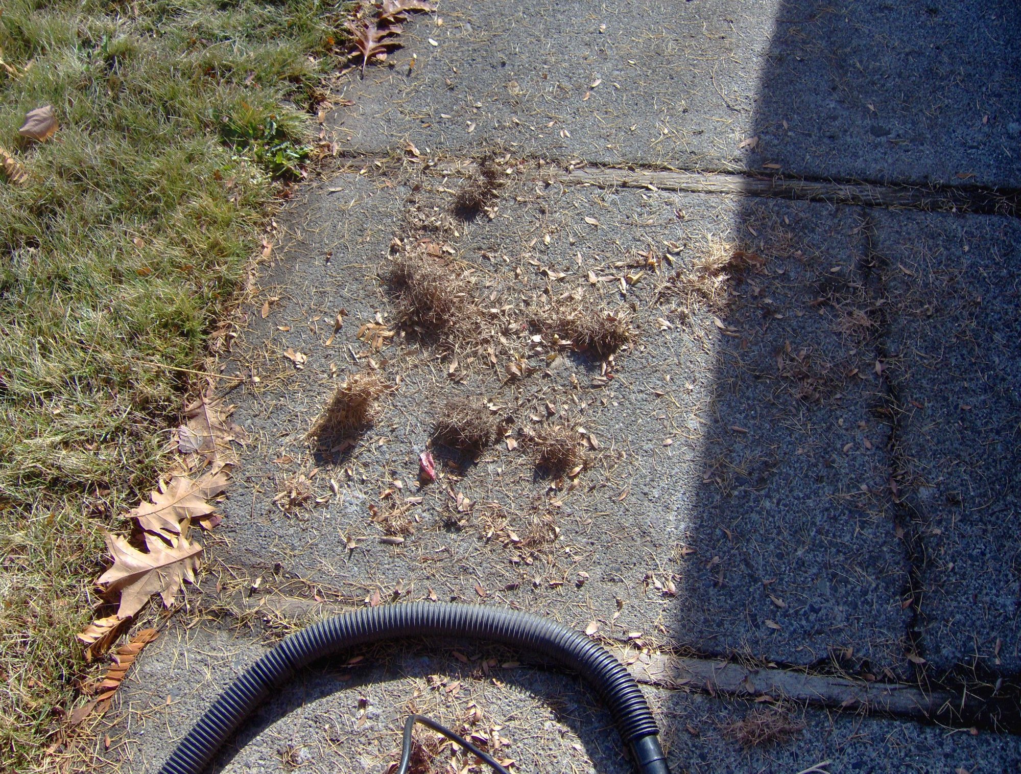

When you have the motor out, be sure to take the opportunity to clean out any leaves and needles that might have accumulated up against the face of the AC evaporator and elsewhere. I was able to pull out and suck out (with my shop vac) at least 6 good handfuls of leaves and needles. I have an ash tree on one side of my driveway and a tamarack on the other. Ugh.
I have the Auto Climate Control and with the temperature control module out, I was able to get to the leaves and needles.
Some of the needles I took out.
