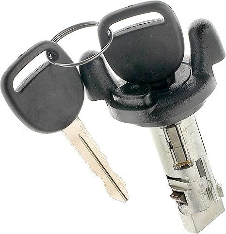

What year is your truck? Does it have a manual transmission?
Trucks with a manual transmission have a key release button that you have to press in order to turn fully to the off position and release the key from the ignition. You say you now have to press a button. Is it possible in reassembling the ignition column you've re-enabled this safety switch that a previous owner had disabled?
Edit to add picture of what I'm talking about. There's a button beside the key that you have to press in order to release the key:
it’s a 1997 with an automatic transmission, and also I had replaced that part but the issue persisted so I’m stumped
