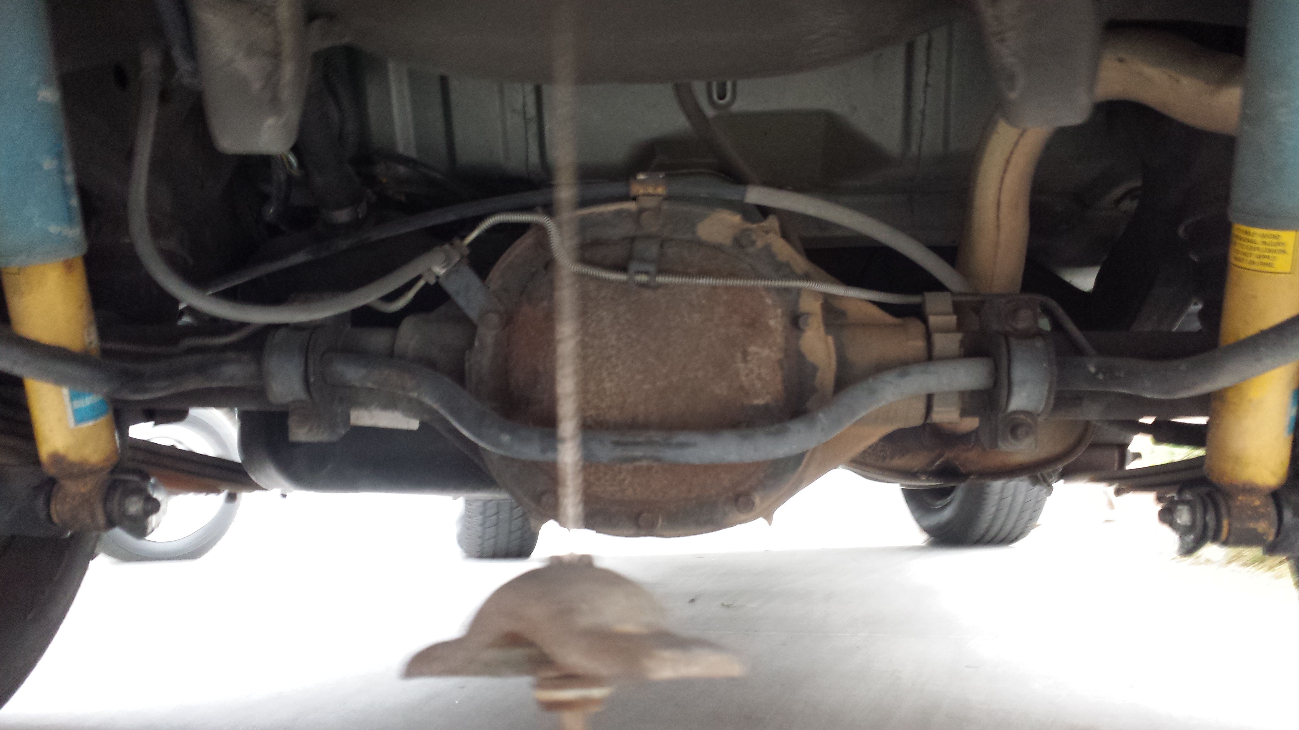

This is a 7.5 rear end correct? 2002 4x4 blazer option RPO GU6 not a G80 option. Going to order a Zexel torsion posi unit not going to deal with this Gov-Lock crap. Who would make a 4x4 without posi smh almost left me stuck. i still haven't got that hose hooked up on the transfer case the part i can see and feel is very odd. it's like a larger hose connected to the t-case then an adapter to go to the 5/32 hose that goes to the y connector. I did get a scrap a/c control panel and it fixed my vacuum leak issue. on the downside the first time i drove it at night a couple bulbs are dead so i get to pull it apart again YAY! probably throw LEDs in it cause why not.

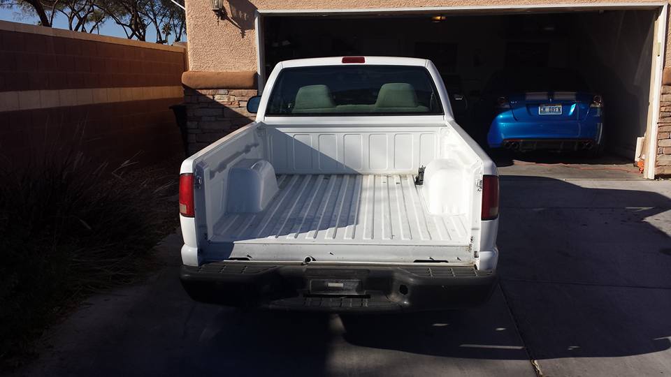

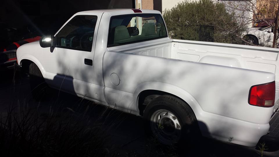

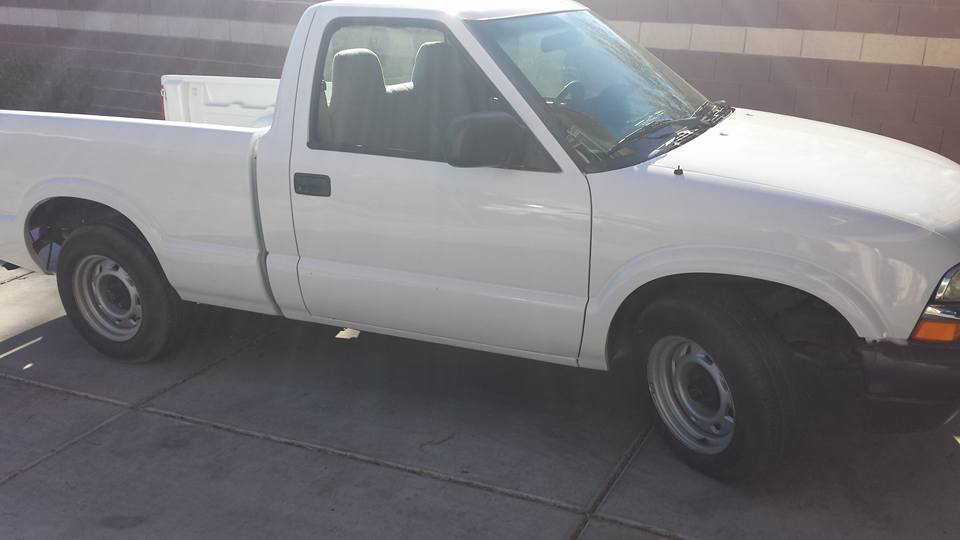

OK so when it rains it pours. my dad called me and told me a story he traded a scrap metal forklift for a 1999 short/short white s10. while it was on a storage lot the window got busted out and the tailgate was stolen. since he didn't want anything else to happen to it he gave it to me to keep at my house. so i now have an s10 too. options are:
V6/automatic
172k miles
that's all everything else is bone stripped.
my 4th s-series 3rd with the 4.3
since it's supposed to rain tomorrow I went to the scrap yard and got a window regulator and door glass and replaced those. since they tried to pry the window open until the glass broke the regulator was shot too. thats all fixed now. while i had the passenger door panel off i decided to look at the driver door since the interior handle and lock didn't work. the door panel wasn't really on except 2 clips which was indication #1 it was going to be more serious to me. once i had that panel off i was looking at the handle assembly which was super jacked up. everything other then the door shape looked wrong to me there was a giant wire harness in the door that looked like the power assembly. i opened the door again and looked at the vin tag and yeah that didn't match but somewhere a 1997 s10 is missing it's door. seeing that had a completely different interior i need another door thats correct for a 1999. no big deal i've taken a door off before.
well drove it around for a minute horrible misfire P0304 - and a cloud of steam coming from the rear driver side of the motor. YAY a third project car! i'm willing to bet intake manifold gasket needed but hoping the guy that traded it to my dad wasn't lying and it just needs a water pump . i hope and pray that compression is good and it just needs a new poppet. my luck is compression is good, water pump is bad, and injector is bad. either way assuming the compression is good i'll need to pull off the upper intake at least.

s10 pictures.
