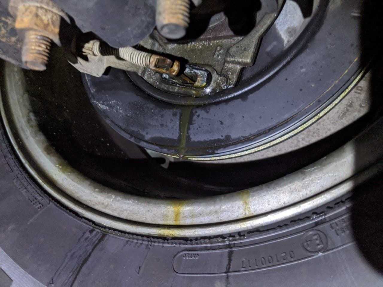

I noticed I had leaking gear oil on my rear, right axle. Obviously axle seal went bad so I replaced it. See photos below.
After having replaced the axle seal, I noticed an improvement in ride quality. It wasn't shaking from the seat as bad as it was before.
So at the time I assume the shaking problems was because of a bad axle seal. I should have replaced the other side while I was at it, but it wasn't leaking so I left it.

Leaking gear oil
