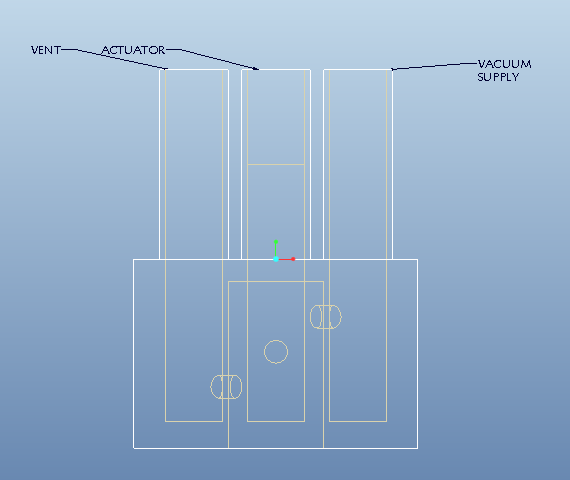

I'll see if I can get either some pictures taken of the vacuum switch I have cut apart or I may just model it in CAD later if I have time. It's hard to get pictures of the switch being all black plastic.
*EDIT* - So here's a rough CAD model of the black plastic portion of the vacuum switch used on the NV231 & NV233:
And here's some photos of the actual switch cut apart:
Basically, the vent port has a hole at the very bottom of the switch, closest to the ball end of the valve pintle. The vacuum supply port has a hole at the very top of the switch, closest to the vacuum lines. The hole for the port that runs to the actuator is smack in the middle. When the transfer case is in 2wd, the actuator port and the vent are open to each other between the o-rings in the valve pintle. When in 4wd, the valve pintle moves up, sealing off the vent port and opening up the vacuum port. Pretty simple thing, but once the o-rings go bad or the valve pintle freezes up, it stops working and causes problems with the front axle engagement. The kind of problem depends on where the valve froze.

The transfer case vent line runs up and is attached to the transmission dip stick. The vacuum system to the actuator is not vented when in 4wd. All of the diagrams I have posted show the complete picture of the system.
