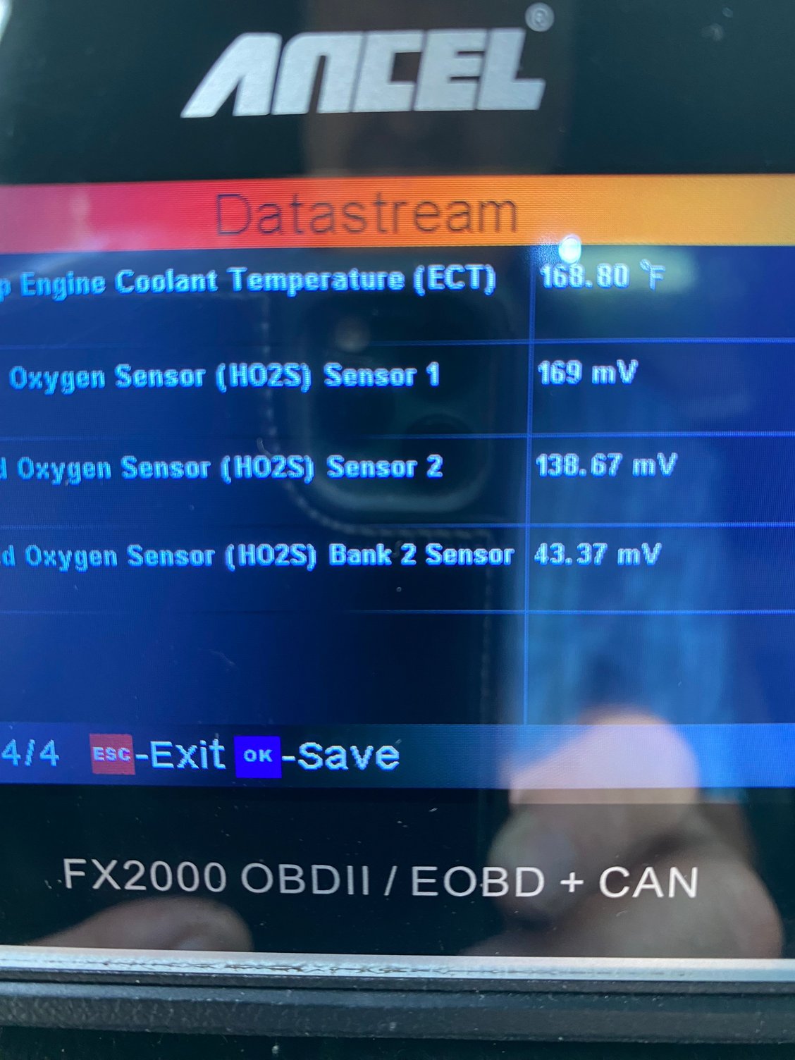

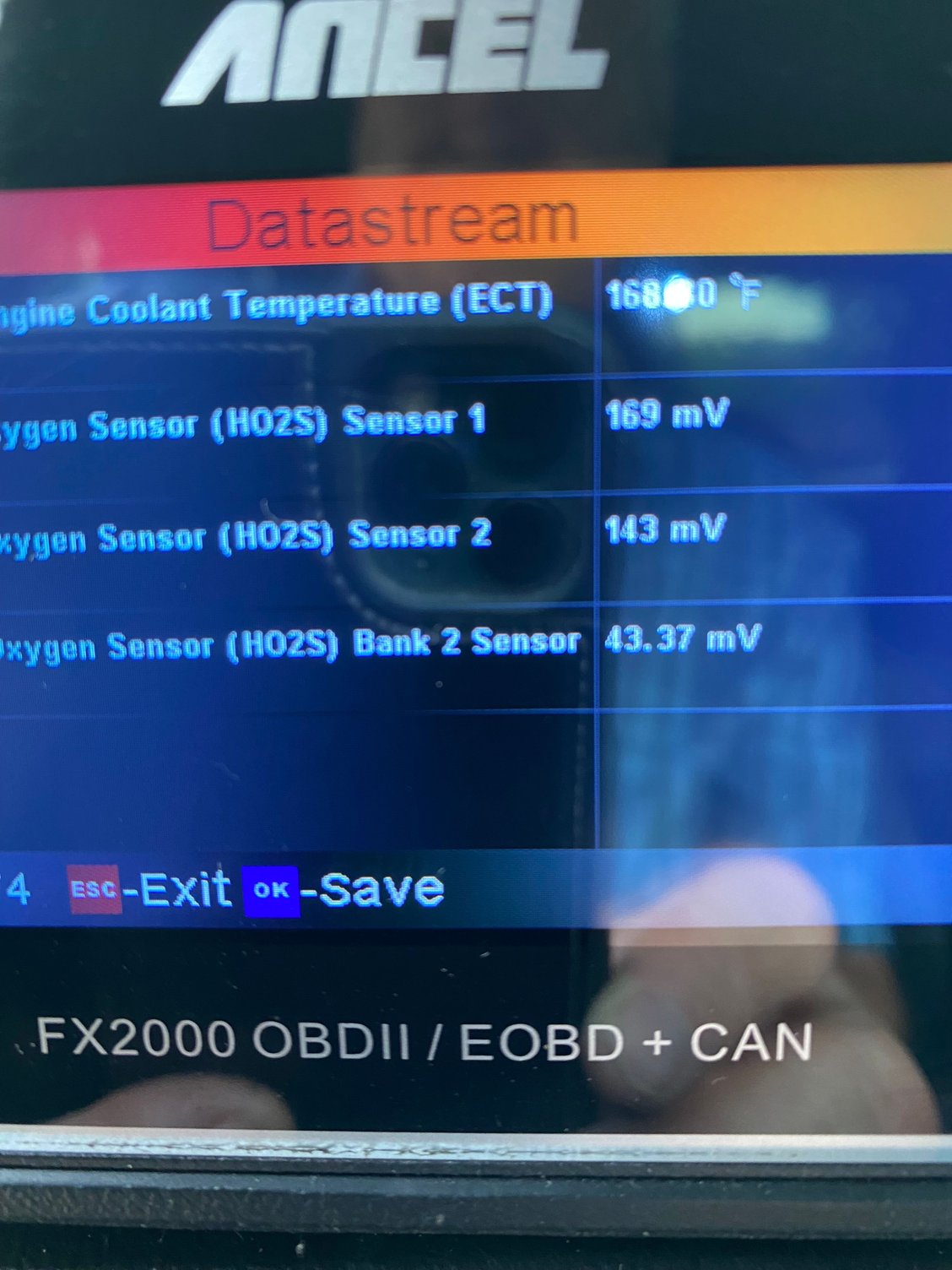

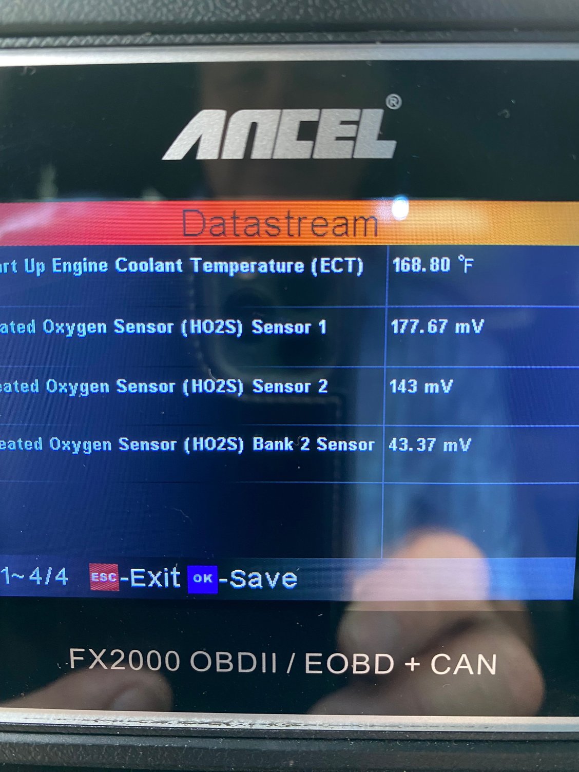

Finally received the ilink 400 with GM data. Guessing I had missed this during all the past scans but the IAT was stuck at 42 degrees but outside temp was in the 80s. Quick R2 of this sensor and test drive around town had my fingers crossed, good idle, good running but my street has a steep hill to climb, got the SES light at about 30 mph 😡🤬🤬. I grab some O2 data and noticed Bank 1 sensor was different from Bank 2 sensor voltage readings.
