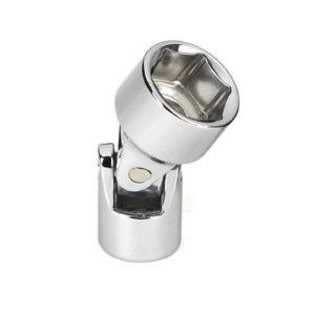

Nope, long, (maybe 24") 3/8" drive extension with a swivel socket gets right on it. A universal and a socket will work, but a swivel socket is easier. Sneak it right along the top of the oil pan, under the motor mount. Ratchet will end up near the serpentine belt.
13mm, 3/8" drive, looks like this:
