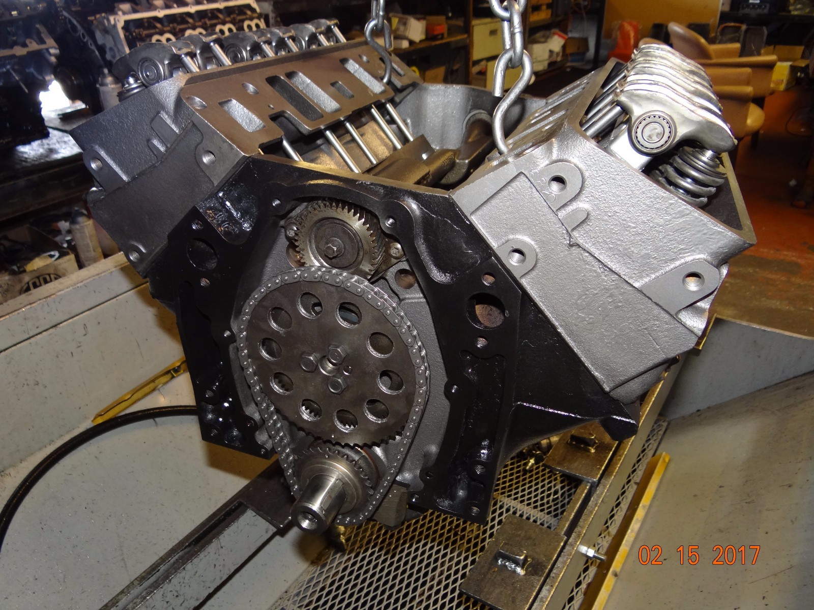

Actually not. Recently I've been buying an engine into the unknown condition. The seller probably wouldn't answer my claims if I had taken out the heads to check out cylinders Neither I wanted to do the expensive and time consuming job with gaskets, planning surfaces and so on, because You can't just take them off and put back.
A simple $15 usb camera fed through the spark plug mount let me do these photos:
