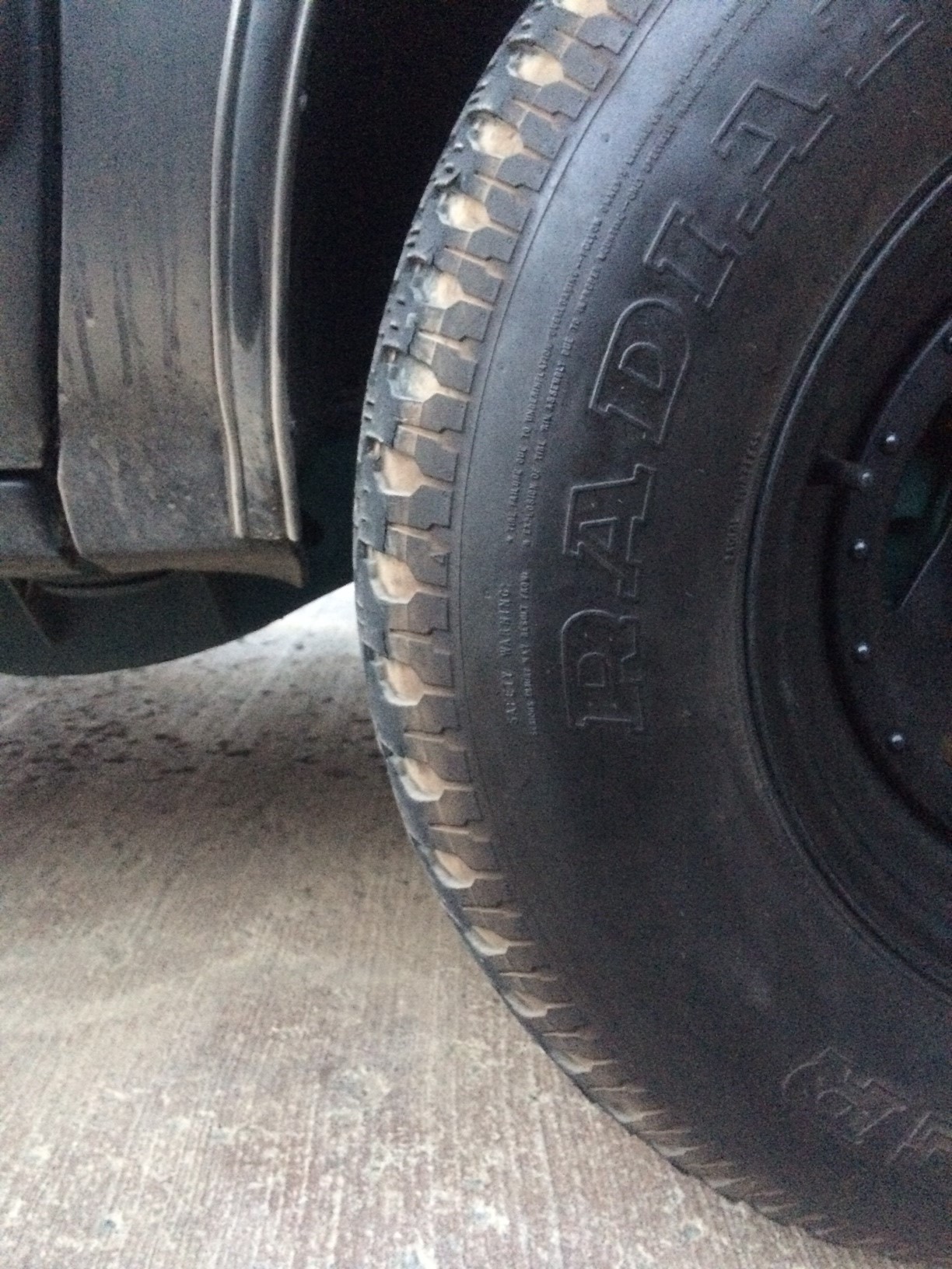

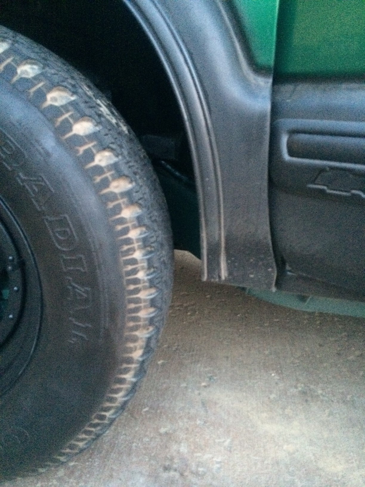

so im trying to figure out why my right tire is rubbing. its only on right tire. all the tires are the same size and have the same rims. its a 1999 blazer 4dr ls.
thanks for your time.
here are some photos the front left has more space then the right.

Are the pictures of the right front tire? If so, post some left front tire pictures for comparisons.
Are you sure front tires are the same exact size? No previous owner put two different size wheels/tires on by mistake??
How does height between ground and the lower control arm compare between left and right sides?
