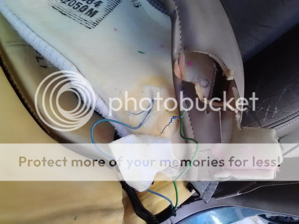

I started looking under the seat, following each wire and loom and could not find ANY signs of damage. As I was poking around I noticed it seemed like the lower half upholstery (correct term?) could come off fairly easy. I didn't take pictures of how it is held on to the metal frame of the seat, but it is best described as a black plastic piece that fits over the metal frame, and kind of clips on there. I took the one on the left and front of the seat off to remove the upholstery. A little persuasion and it comes off easy as cake.

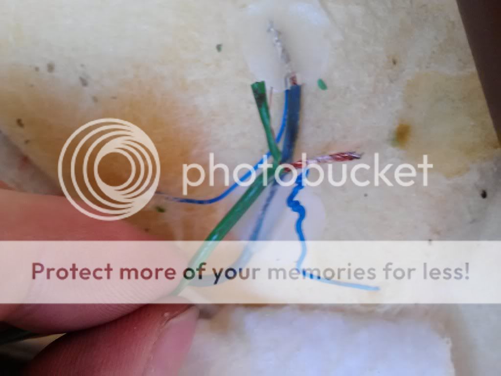

After getting the upholstery loose enough to where I could flip it up, I immediately noticed my problem. It seems there are four wires related to heating. There are two of the smaller blue wires, and the big blue and green wires which must go to the switch. The bigger wires are twisted together with the smaller blue wires, and then a dab of hot glue is put on them. This is how they come from the factory, as far as I know. The green wire was severed from its blue wire.
A quick twist of the blue and green wire, and a drop of solder on them and I now have a nice heated seat! To finish it off I put a drop of hot glue on the twisted pair, and another drop to secure the wires to the upholstery. I then glued the piece of fabric that was covering the wires back on. Slipped the upholstery back in place and I'm done.
First pic is a wide view of the whole seat, second pic is the two wires that were broke apart, I had already twisted them back together in this picture. The third picture is a view of both wires, so you can kinda see what I'm talking about.
