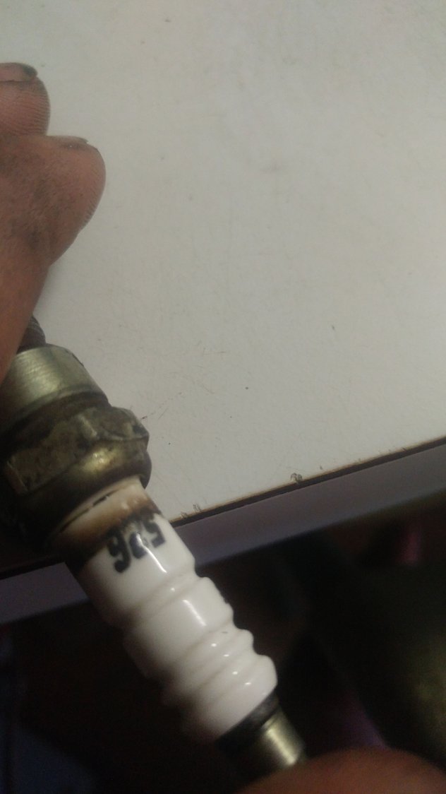

Thanks for the input ebbervonfloyd, so i went to check for spark on #6 cylinder, plug was wet with gas. Hooked it up and set it down so i could see spark, as soon as i fired it up got a nice pop. Shut her down and was greeted with a nice cracked plug jacket, and turns out the electrode was broken. Plugs had about 10k miles, im guessing it had an internal breakage and my test totaled the plug completely threw in an old autolite platinum and bam seems to be fixed now. This drove me crazy. so like ebbervonfloyd said check your plugs, even if they seem ok and are new. i wish i had discovered this before tearing apart everything on my blazer but now i know better for next time
You can see the crack here, electrode broke in half with a little force. These were accel copper core performance plugs with 10k miles. Will go for delco double platinum next time, always use AC parts.

I am very happy that it fixed the problem for you. My plugs were AC Delco Iridium and like I said very few miles. My friend has a ecoboost pickup by Ford and they are having problems of the Porcelain breaking out the side also.

Make sure your not breaking the plug body with the socket during the plug install by getting off center when you crank it down.
