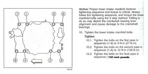

When you did the LIM gasket, did you:
1. Chase the threads on the intake bolts.
2. Chase the threads in the heads.
3. Put sealer on the intake bolt threads.
4. Use the correct tightening sequence on the bolts, (3 steps).
5. Use the correct torque on the bolts, (132 inch pounds).
If you missed even one step, the bolts can loosen up and cause a vacuum and or coolant leak. If you have an accurate inch pound torque wrench, you can try tightening them. After 3+ years and 50K miles, the rubber is not real pliable. Not sure what kind of success you'd have, but it can't hurt to try. Make sure you tighten them in sequence.

Attached Thumbnails Need help p0300 and slight backfire-intakemanifold001-copy.jpg

1. I could not find the correct tap so NO I did not chase the intake bolts
2. I don't remember removing any head bolts
3.I used red loctite on the bolts
4. Yes I used the correct sequence
5. I used the correct torque
So I think I will try to torque the intake bolts again

5/16 x 18 thread, you'll need a tap, and a die. If you did not chase the intake bolt threads, or the threads in the heads, the old sealer that was left on the threads will cause the bolts to bind up when you install them and the actual torque that you applied was substantially less than spec. Loctite red 242 is a thread locker, and it won't do any good to try to re-torque the bolts now because there's too much crud on the threads, (you'll never get an accurate torque applied). Torque spec is 132 inch pounds, (11 foot pounds) which is very low torque to begin with. Some of the intake bolts go through the head and into the valley, (there's oil in there). The thread sealer keeps oil from travelling up the bolts. With such low torque, they can "walk" out from normal engine vibration, and the oil makes it easier.
It wouldn't surprise me a bit if the gaskets are leaking, and at this point, you have no choice but do the job correctly before it causes MORE problems. Tell the boys at the auto parts store that you need Loctite thread sealer, not thread locker.
