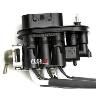

Pretty straight forward job. Be careful when disconnecting and connecting the electrical connector on the injector housing, (terminals bend easily). Make absolutely certain the injectors go to the proper intake ports. The lines are numbered on the outside of the injector housing for the cylinder each one goes to, you can see them in the image below. This is the passenger side:
Do not snap the nozzles into the intake ports until you are certain they are oriented correctly. Once they snap in, they're a PITA to release without breaking them. Passenger side is 2, 4, 6, in order, front to rear. Two of the lines on the driver side cross over each other, (notice the old one before you remove it). You will need to rotate the injector spider lines on both of them so the lines do not kink. Grasp the line close to the injector housing and rotate it, (requires some effort) so it's pointing to the port that it goes in. Just prior to installing the plenum, coat the injector housing O ring with clean motor oil. Any questions, just ask.
