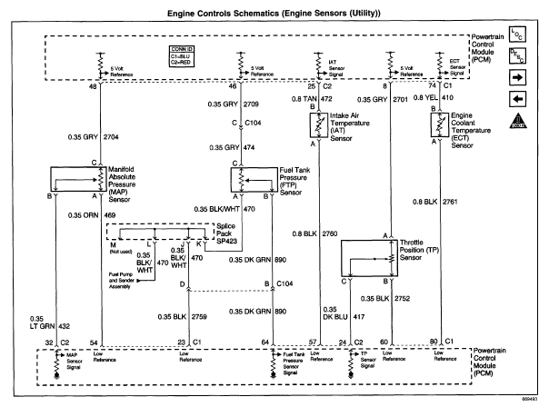

Looks like old photobucket links to images are not working in link. Here are the missing diagnostic charts. A P0452 shouldn't be very difficult to diagnose. If your scanner doesn't do fuel tank pressure / volts, I recommend Car Gauge Pro for Android and the BAFX Bluetooth OBD2 adapter as sold on Amazon - about $35 total. At least it will display fuel tank pressure / volts on my 2001 (as I determined when I was working on my EVAP system).
