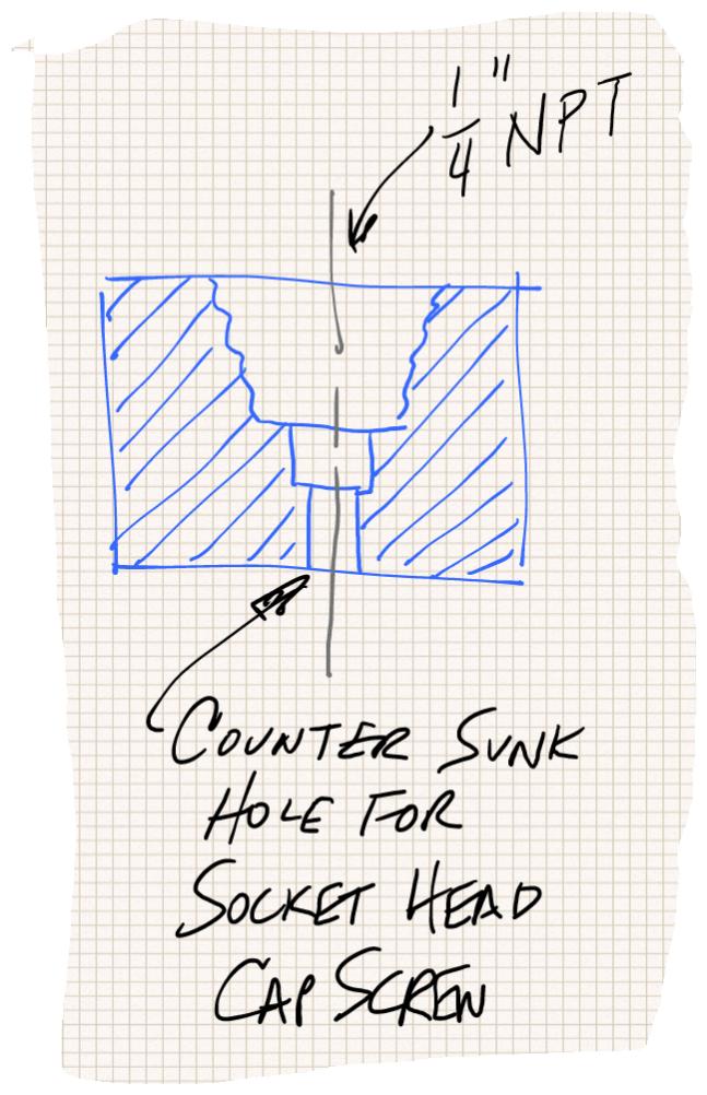

Hes using a newer engine,which has a different style knock sensor. If you are still using the 99 wiring and computer,use the sensor from the 99. Thread and bolt size should be the same as the newer,if not you might beable to get a adapter from ace hardware etc to make it work. It senses vibration. The adapter might work. Just get a brass fitting etc.

Old Jul 25, 2013 | 09:53 AM
Posts: 41,341
Up to sometime in mid-01 (or was it mid-02...), the knock sensor thread was 1/4" NPT (national pipe tapered) and were a single wire sensor. It then changed to bolted on sensor two wire sensor.
You will not find an adapter to go from the straight thread bolt hole to a tapered thread hole. You could fabricate one that would have a counter-sunk through hole for a socket headed cap screw that would thread into the block and on the other end have the 1/4" NPT thread for the single wire knock sensor. Attached is a quick sketch of the adapter I described above.
I am not sure if anyone has tried just grounding one side of the two wire sensor using the standard harness connector, then hooking up the other wire to the stock single wire that runs back to the PCM. I am not sure if this would work, but it could possibly be cheaper than fabricating an adapter and would certainly be easier if it works out properly.
