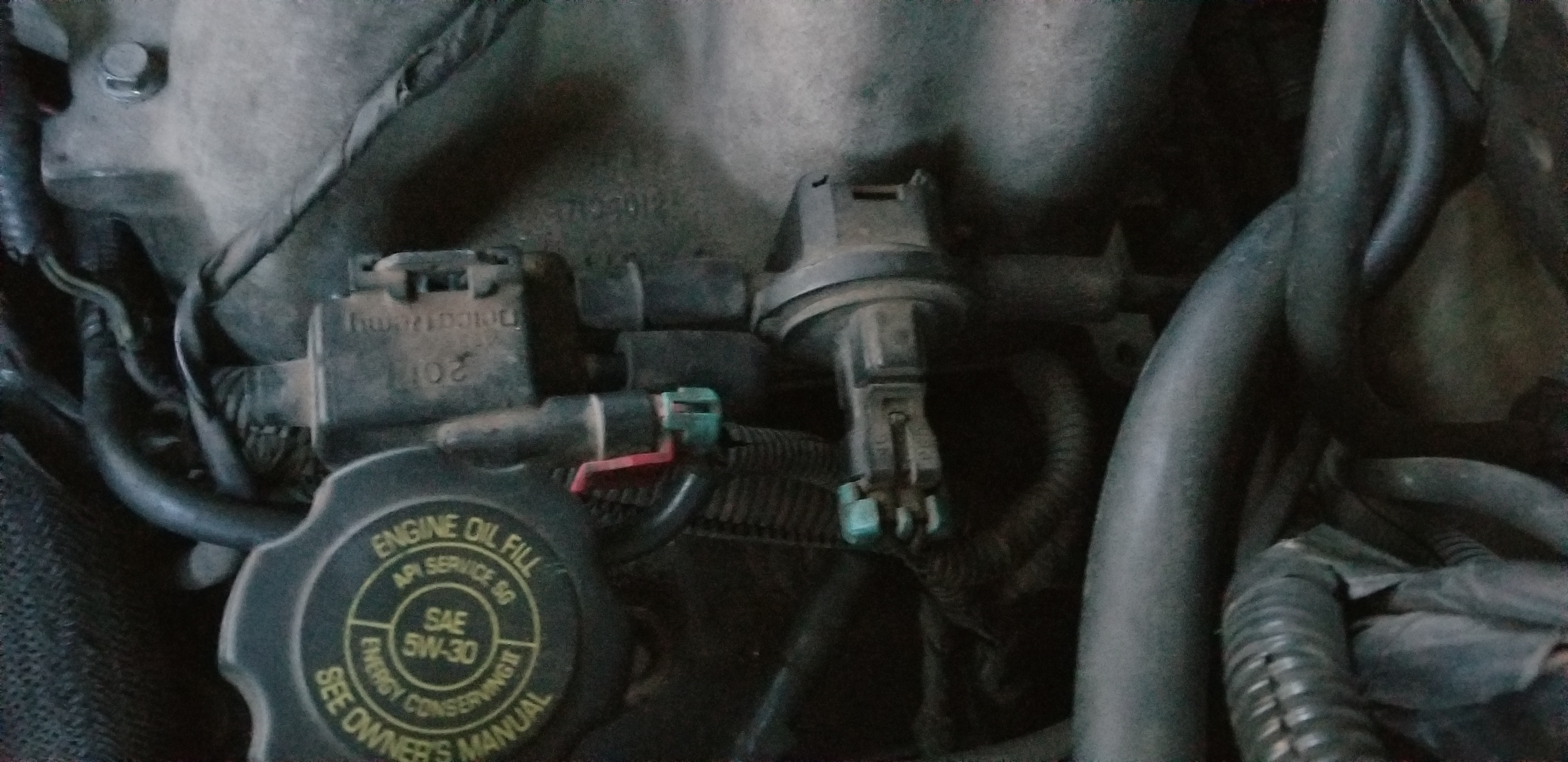

Edit: Ok, went ahead and took a picture of the evap setup, to aid in diagnosing. This located on the driver side, and is mounted using two of the intake plenum bolts. (Sorry for the grainy pic, it was pretty much dark outside)
Also, went ahead and taped off the hose going to the manifold. We'll see how she does in the morning.
Edit #2: Had a quick errand to run, so I put about 9-10 gallons in. Epic fail. Ran like crap, could barely get out of it's own way. This was with the evap line to manifold blocked off. Did give me a P0441 code, lol

One of those solenoids should have a GRN-WHT wire going to it (don't have a diagram so I'm not sure the other wire color). The solenoid with the the GRN-WHT wire is the purge solenoid. I think it might be the one on the left? The PCM controls that solenoid by providing the ground through that GRN-WHT wire. The other wire should show IGN(+). It is a pulse width modulated solenoid and the PCM uses engine temp, operating time and other factors to determine the duty cycle on-time. It's kind of limited the tests you can do without a scope, but I can pass along the resistance test for the purge solenoid, though I realize that can be of limited help. Key off, disconnect solenoid from harness, using an ohm meter across the solenoid terminals, resistance should be 25-30ohms.
There is a DC voltage test for the vacuum switch, but I honestly have to jump off right now. Oh, and this is nice...your truck came with three different wiring possibilities for the vent solenoid. Also, I'm using vin "W" for your truck, is this correct?
