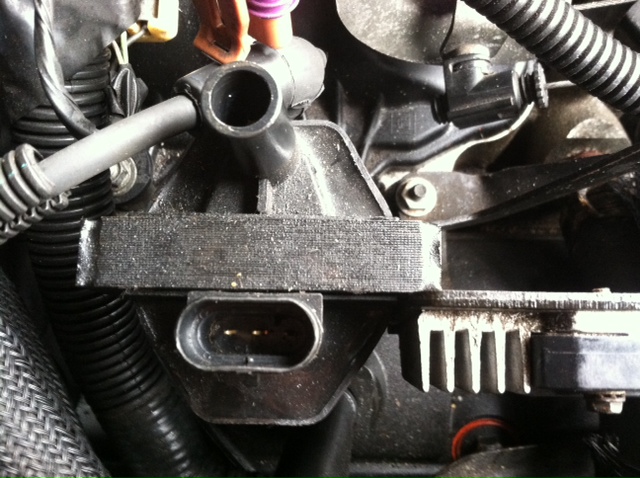

My book shows OHMS test for ignition coil 3 tests. They show a 4 prong coil connector Mine has 3 how do I test it?
I replaced the dist cap and button
I tested the triggering signal at the coil ignition module with an LED results were it lit up when connected and blinked when cranking the engine, was that good?
UPDATE here is what I got Analog meter OHMS

I'm getting spark to the distributor now, according to my spark plug tester, NO spark out of my new dist cap.
I removed new dist cap and bent the contact tab on the button up a little to make sure it had contact.

OK FIXED,
I was getting spark to the dist not good spark, not enough to feed through the dist.
I could not figure out how to test the coil properly so I took the coil and ICM to autozone they tested the ICM it was good, they could not test coil.
I told them I bought that coil from them 2 years ago he replaced it no charge lifetime warr.got home 3 min. later I was running.
To recap: Truck turned off at 60mph left with no start situation towed it home.The batt was real low pulled the alt autozone tested on the machine, FAILED voltage to high, possibly VR failure.Installed new ALT after they tested the new one, still no dice. I pulled the distributor cap it looked bad for 2 years old white scale looked like frost on the contacts, replace cap and button.
Still no start, weak spark from coil to dist. no spark out from dist.Installed new coil truck started. Thanks for the help provided.Back on the road.
