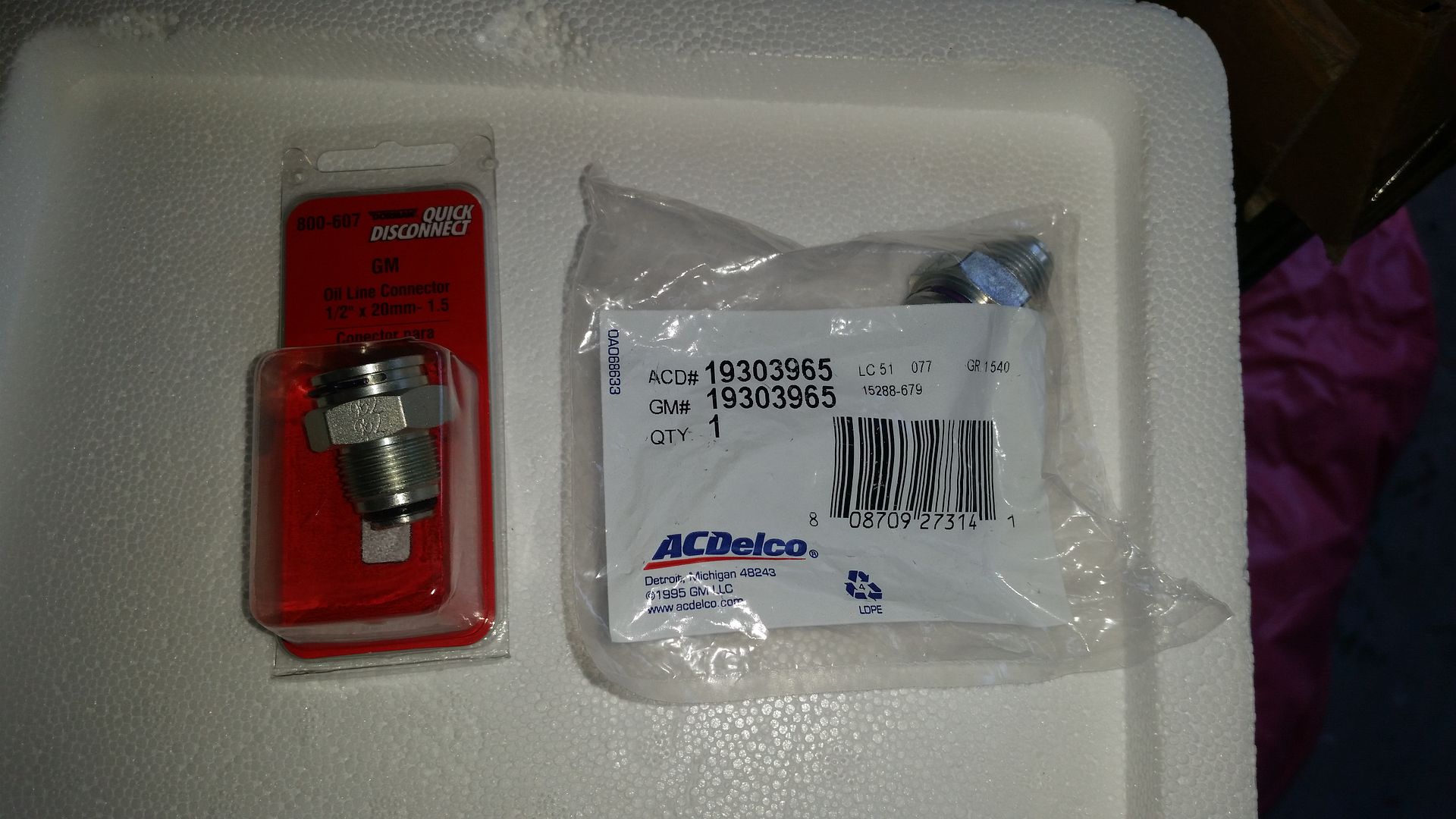

I did discover that the Dorman replacement fitting you can get at most parts stores is the EXACT same fitting, down to the manufacturer ID stamped on the side of it, that a dealership will sell you in a AC Delco branded wrapping for $3 more lol
