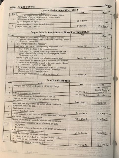

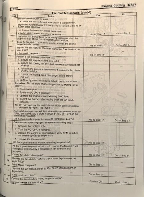

Seems to be better now. Condenser wasn't really dirty, but I hosed it anyway, I straightened the fins some, and I drained/refilled the radiator/reservoir. Following George's troubleshoot guide, I still suspect a worn fan clutch which I will get to eventually. Temps seem under control for now.
